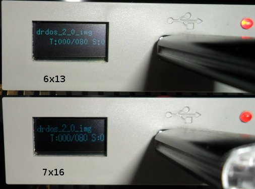

Very nice! but won't they look too small on a 0,91" oled screen?
Re: OLED mod
aotta wrote: Mon Sep 04, 2017 9:47 am
Jeff wrote: Mon Sep 04, 2017 8:52 am
6*13 font !
:D
The best is to try and tell me !:

cool, now only have to mill the window a little wider...
Re: OLED mod
Kingstener wrote: Mon Sep 04, 2017 12:04 pm cool, now only have to mill the window a little wider...
No, no need, i can reduce the character spacing, this is just a setting.
Re: OLED mod
Jeff wrote: Mon Sep 04, 2017 4:44 pm

ok, now it fits, but looks a little small ;-)

Kingstener wrote: Mon Sep 04, 2017 6:11 pm ok, now it fits, but looks a little small ;-)
But is not the same font you used on your oled project?
Kingstener
Posts: 67
Re: OLED mod
Post by Kingstener »
I use the second (7x16) it's the maximum who fits in the window
Of course, the 6x13 is also readable without (my) glasses, due to good contrast of the OLED

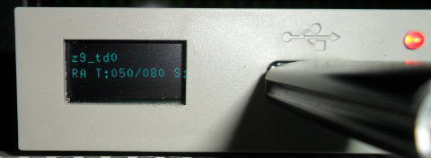

..and my personal contribute to testing:
i find it nice and sharp, and it's better in real than in photo... quite perfect for me, good work Jeff!

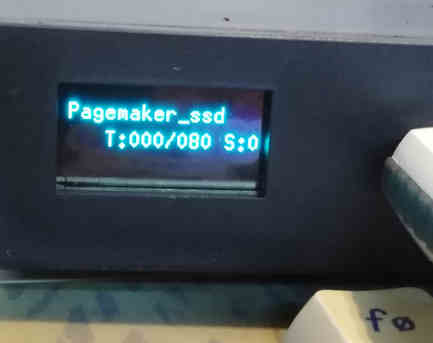

I've put together a design for a 3D printable replacement casing for the Gotek drive. Here's a preview. You should be able to generate either a full box + lid, or a "frame" that includes a face plate, the supports for the board, and enough of a skeleton to give a reasonable amount of rigidity and the usual mounting holes that are found along the side and bottom of a floppy drive.
You can also:
  1. choose between support for the Gotek drive's own three-digit LED display or a 0.91-inch 128x32 I2C OLED module
  2. You can further change the overall width & height of the bay, offset the mounting &c so that the USB connector is not in the center, and add extra space between the display and the USB port
  3. Choose between 1 or 2 LED holes, and 2 or 3 button holes
  4. Specify the thickness of wall and floor/ceiling material, for example to adjust to printers with different nozzle sizes
  5. Add 'extra space' to all holes to compensate for over-extrusion on your printer
I printed one today as well, and took some pictures:
it came out quite well. As you can see, the OLED display is nicely framed, aligned with the USB connector, and with the entire display area visible (though the firmware running on it at the time uses a smaller font). There's also a hole for the third button, but I still have to put that in place.
Best wishes
// Christian
