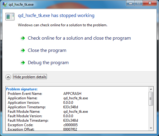

I can't convert Akai S-612 and S-700 .QD files to .wav. When I run the program qd_hxcfe_tk.exe with parameter -checkakaiqd on Windows 7 or 10 it prints "Saving inverted MFM track <inverted.INV>", creates empty file inverted.INV, then crashes with exception code c0000005. When i run it on Ubuntu 22.04 it prints "Segmentation fault (core dumped)".
Built on Windows with Microsoft Visual Studio 6.0, on Linux with gcc
Would you share your own build, please?

Which QD file and firmware are you using ?

Most of these QD files appear to have a bad file header.Brye wrote: Thu Oct 06, 2022 8:04 pm I tried to convert these files: http://zine.r-massive.com/akai-s612-archive/ http://zine.r-massive.com/akai-s700-archive/
I don't have Akai samplers nor a floppy emulator so I would like to extract the samples and use them on my computer in DAW.
I have updated the tool to try to support these QD files :
https://github.com/jfdelnero/HXCFE_QuickDisk_Toolkit
