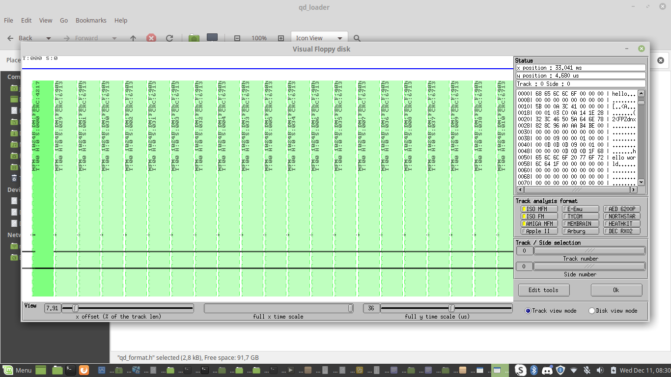

I did it quickly this morning :
I can see your "hello world" message ;)
And the export to a raw/img file works "out-the-box" :
DSKA0001_ToFormat_QD.img.zip
(407 Bytes) Downloaded 33498 times
EDIT :
If you want to try it, replace the hxc tool dll with this one :
http://hxc2001.free.fr/vrac/libhxcfe.dll.zip
:D

it works beautifully :) I converted the .QD file to raw .img file and I was able to read it in HEX editor. Is it possible to convert the img file back to .QD file? This way I will be able to sometimes type on my computer and continue back on the word processor.
Re: 2.8" QD Disk Emulation
hedehede81 wrote: Thu Dec 12, 2019 8:06 am it works beautifully :) I converted the .QD file to raw .img file and I was able to read it in HEX editor. Is it possible to convert the img file back to .QD file? This way I will be able to sometimes type on my computer and continue back on the word processor.
i am finishing the export support ;).
