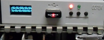

More on the hardware side of things,
The OLED display is a bit wider than the aperture that is present for the LED display that is replaced, so some of the OLED display ends up hidden (which in turn requires the narrower font in order to fit 16 characters). The material to the right (if you're looking at the gotek emulator from the front) of the existing aperture is just the shell of the emulator, and it seems it could be possible to extend the aperture a little (towards the center of the front of the emulator), though the material there is quite thick; this would then allow using the entire width of the OLED display and would make the text perhaps just a little more legible by allowing a little more space for each character.
Does that sound feasible at all?
// Christian
Re: OLED mod
Yes it is !

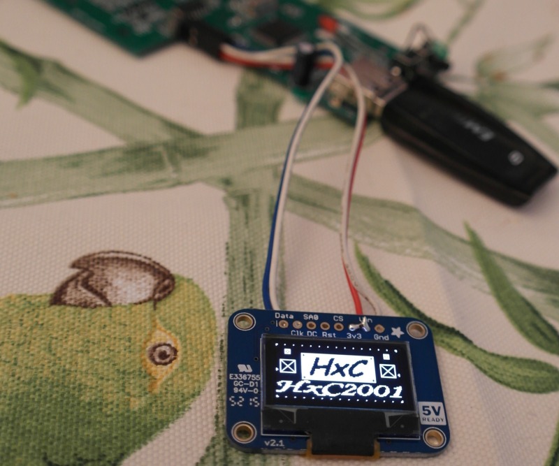

Re: OLED mod
Screens received !
Work in progress !
:D

Re: OLED mod
6*13 font !
:D
