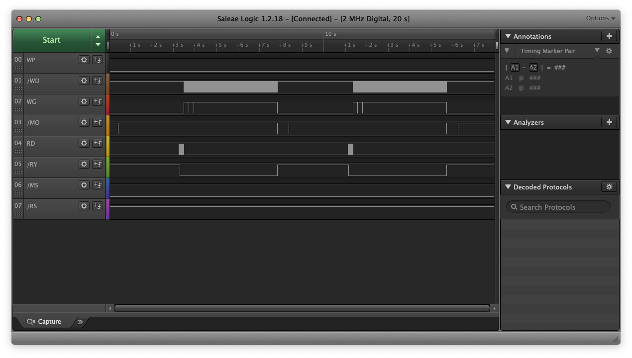

How about this for "interesting". This is very strange...
Schermafbeelding 2019-09-18 om 09.10.12.png (139.63 KiB) Viewed 395152 times
etaoin
Posts: 43
Joined: Mon Sep 16, 2019 3:10 pm
Re: 2.8" QD Disk Emulation
Post by etaoin »
That is the Gotek trace
etaoin
Posts: 43
Post by etaoin »
It looks like during a write you need to push out the written data on the RD line, and because it doesn't see that, it retries the write and gives up after the second attempt.

etaoin wrote: Wed Sep 18, 2019 9:15 am It looks like during a write you need to push out the written data on the RD line, and because it doesn't see that, it retries the write and gives up after the second attempt.
Yes !! This is exactly what i suspected : Two Write cycle back to back without a true "verify" at all !
This is maybe a rd data line issue, but i still suspect the ready line. i will have a closer look to the traces.
this wr to rd bridge was mentionned some thousand of posts above but i still really hope that this is not the reason because this is quite hard if not impossible to do this with this uC... Unless he just want some random data stream...
As i said above : This thing is crazy :!:

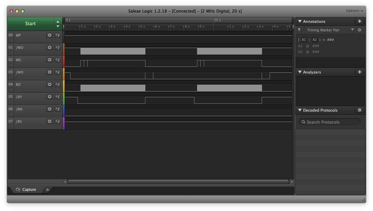

Jeff wrote: Wed Sep 18, 2019 9:58 am one thing you may try : disconnect the RD line from the Gotek and connect it to Write data to make a loopback. Then check if the Roland does 2 writes back to back or if it try to do a really verify after the first write.
Two write cycles. It won't match as RD needs to be inverted from /WD.
I'll throw in an inverter to see that that does.

No go with an inverter (just to rule that out)

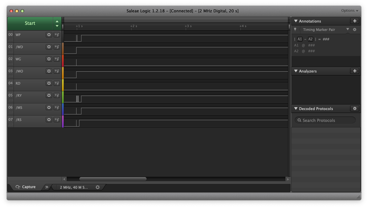

Something I just remembered I wanted to check: the Reset line does go low straight after power up.
Schermafbeelding 2019-09-18 om 10.17.59.png (139.77 KiB) Viewed 395139 times
Jeff wrote: Wed Sep 18, 2019 10:15 am And btw the motor signal "glitch" at the end is maybe to clear the ready signal... i maybe forgot this...
Yes. This seems to be the case with the real QD drive : MO and RY are synced at the end of the write. This is the issue.
Let me add some ASM instructions in the code ;)
