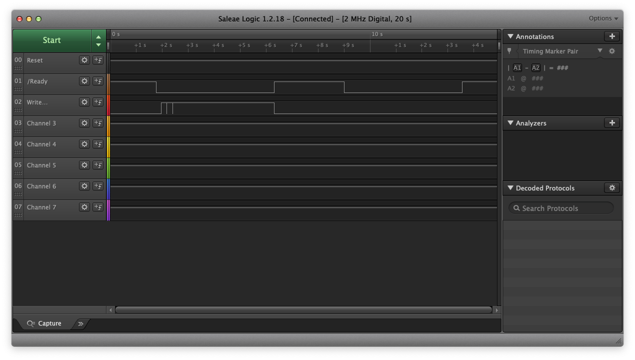

Re: 2.8" QD Disk Emulation
This is a write trace.
It actually did three passes, where the third fell just off the 20s window. Not sure why three, it looks like it's only doing a write in the second pass.
Note, this is an A/B sample, so it will ask you to change the disk between saves. That might have something to do with the additional read cycle. I'll do one that is single-sided.
Addition: the first read pass is of course the overwrite check where it checks if there's already something on the disk.

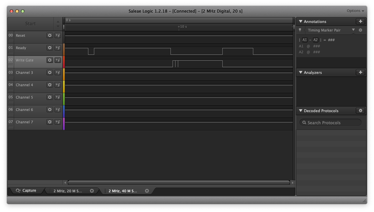

Write cycle after overwrite check (I waited for the drive motor to stop before confirming overwrite), so this is a write and verify cycle.
So you're right on the Reset line. It doesn't seem to do anything at all.
- Schermafbeelding 2019-09-17 om 12.06.13.png (141.89 KiB) Viewed 176969 times
ohh thanks a lot ! So this confirm that you have also this short ready state here :
viewtopic.php?f=2&t=773&start=375#p21408
And we can also see the 3 blocks write .
Can you add the others signals on the others channels ? (MO, RD data, WR data...)
Is it on the real QD drive ?
Can you export these data to a file ? i want to check some precise timing.

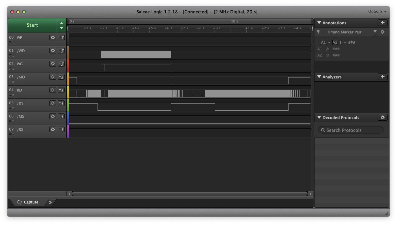

Yes, this is on the real drive.
I was just wiring it up for the full 8 channels.
full probe
