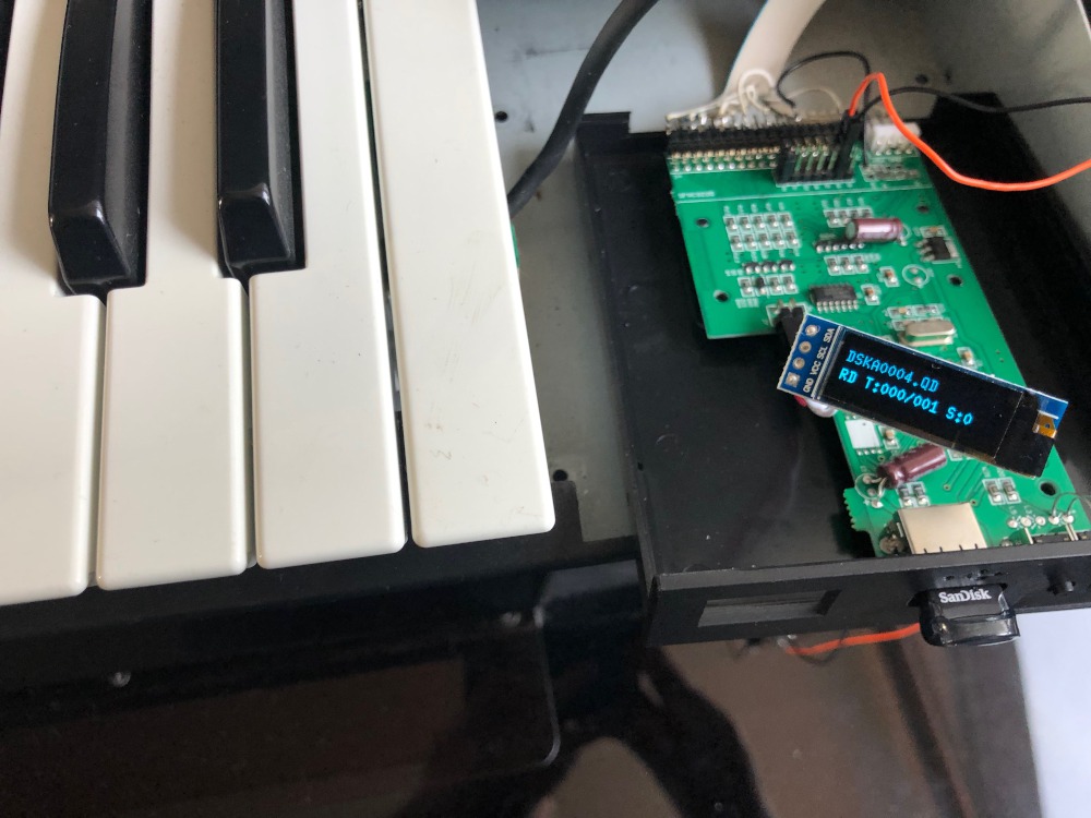

Hi all. I'm new to this thread and I'm slightly overwhelmed by the number of test QD-images that is available.
I haven't found anything yet that doesn't say "Illegal QD", but I must admit I haven't tried all of them. If I select a different image on the Gotek, the S10 correctly goes to "Insert QD", so it does notice a disk change. After the change the OLED outputs "RD" in the lower left corner, so I assume that is coming in correctly as well.

After writing the above post I came across an earlier "0004" image that does allow me to write (with verify error) and properly read back, so that might be the same image. But will verify that this one works as well.
My Gotek is currently three button with OLED, so I can name it whatever is needed. Will probably change to rotary encoder later.
Firmware is 3.4.7.1a
