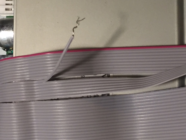

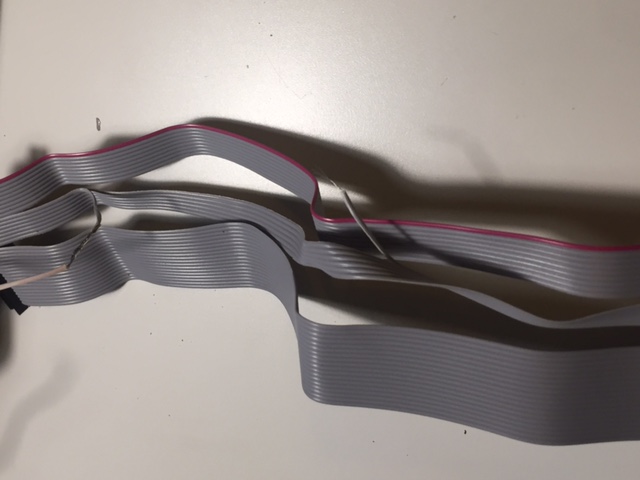

i got that floppy cable, but.... where should i cut?
Re: SP1200 with external cased HxC Floppy Drive Emulator
you got a switch that was described earlier? find the graphic on side 2 .
it´s line 10 you´ll need to cut on 2 points.
find line 10 when you count from the red line (line 1)
it´s easy. you´ll need to do the cuts between the plugs. between the first and the second plug, and another between the second and the third.
then it´s important, how you connect the lines to the switch. line 10 comming from the first plug (connected to the mainboard) needs to be connected to the middle pin of the switch.
then you´ll need to connect the lines that lead to the second and the third plug to the other pins of the switch.
that´s it.
check out the graphic on side 2 . you´ll get it.

and a 3 plug floppy cable to connect the floppy and the HXC but you cut the line 10 ?

About the switch: You´ll need to cut line 10 and connect this to the switch (see grafik before) . This line contains the adresssignal (e.g. ID 00, ID 01 etc.) . The switch directs the adress-signal to ether floppydrive or hxc. This signal tells the drives, that the SP is "talking" to them. If one of the drives doesn´t get this adress signal, it doesn´t react. That´s the reason you can switch between them drives.
About the switch: Check out the grafik . You should get a switch like that at a electronic store like conrad etc. . The format and the look is not important. But you need one with 1 input and 2 outputs.

About cutting and soldering line 10: I'll try to post some photos of this action to make it more understandable.
Shure you'll need to solder. You'll need to lenghten the cut lines and connect it to the switch. The connections have to be soldered and should also be isolated by isolation tape.

The parallel floppycable is a floppycable with one connection plug for the floppyoutputslot of the Sp 1200 and two output plugs for two floppydrives to connect to.

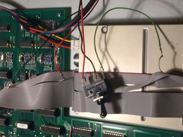

I finally collected all materials and made the mod.
Everything works but I think I have a jumper issue:
The HXC boot and load perfectly but when I switch to the floppy disk, the green light blink ( as well as the small r d light in front of the HXC...????) but i can't load anything.
The screen says "disk not formatted" but the floppy contains sounds and sequences.
I tried different configurations ,with the switch and cables : no success.
But i noticed the jumper 1 on the HXC was on so i placed it like the all 7 others and then the floppy is working correctly.
But now I can not load from the HXC if I dont touch the jumper 1.
Do you have an idea to solve this problem ?
Also, if the switch is in the middle position, the HXC react to load/ save command from the SP, is this normal?
I think its just a jumper configuration but maybe a cable wiring?
What do you think?

I think it´s no jumper issue. I think you use the wrong wire/line and the switch is not optimal (or not right connected). My tip here is to read the topic from the beginning again to get the logic behind the mod. . I got some tips from other users too, that helped me to understand the logic, how all this adress-signal-stuff works. If you once get it, it´s pretty easy. It took me a bit as well to get it.
I think your main problem is in the wiring. Also a problem with the switch. First check out if you use the right wire (line 10) of the floppycable. Normaly wire 1 (line 1) is the coloured wire. Count from there to wire 10. You can also take a look onto the floppycableoutput-slot on the mainboard to oriantate. There should be a "1" written for wire1/line1 on one end of the slot. It should be on the same side, where the cable is coloured. If not, the cable might be connected the wrong direction.
Looks like the wiring from the hxc is ok, when the switch stands on position 1. But I think it´s actually not really the right wireMix-club wrote: The HXC boot and load perfectly but when I switch to the floppy disk, the green light blink ( as well as the small r d light in front of the HXC...????) but i can't load anything.
Leave all Jumpers adressed to ID00. Once again. Try to get the logic behind all that. Then you will do easier to get the issue yourselfMix-club wrote: I tried different configurations ,with the switch and cables : no success.
The jumper of the HXC must be always set to ID00. Same with the Floppydrive ID00 (It´s logicaly already set to ID00, otherwise your drive had never worked
OK, first Check out the wires (wire/line 10). Second check out the connection of the wire 10 to the switch (I think, you can use the switch you got, but with 3 positions you got to find the right connections) .Mix-club wrote: Do you have an idea to solve this problem ?
What do you think?[
Use a voltmeter to check the signalway of your switch to connect the wires correctly
Check out the sketch I uploaded on site 2. It´s not perfect, I know, but I think you´ll get it now.
Could you upload some photos?
You can also send me a PM. Maybe better to send your cables over and I do the modification for you?

Thank you for your reply, well I think I understood the processs of this mod: I rode the whole thread while I was queueing at Disneyland with my kids so i rode all posts about 10 times!
Maybe more times later on....
I think the wiring for the HXC from the switch is good because the HXC responds and load files.
Does it makes a difference if the HXC is after the floppy drive on the floppy cable?
The line to cut, number 10 is the 10th line including the red line or the 10th wire AFTER the red line?
I don't know about my switch, I wanted a 2 positions one with 3 pin, ordered it from Conrad, but when it arrives I realised there were 3 positions.
About the jumpers: I cant find the jumpers on the SP floppydrive, just wanted to make sure it was on 00.

Here are some details and the line I cut.
I checked again, seems to be line 10?
- IMG_2255.JPG (84.95 KiB) Viewed 53184 times

Here you can see the switch and the 3 wires, I removed the tape to be more clear
- IMG_2256.JPG (112.23 KiB) Viewed 53184 times

I think I find the issue:
Between the 2nd and the 3 rdv plug on the floppy cable, the second part of the cable is inverted :
So from the second plug it's line 10 and on the 3rd one it became line 16!
