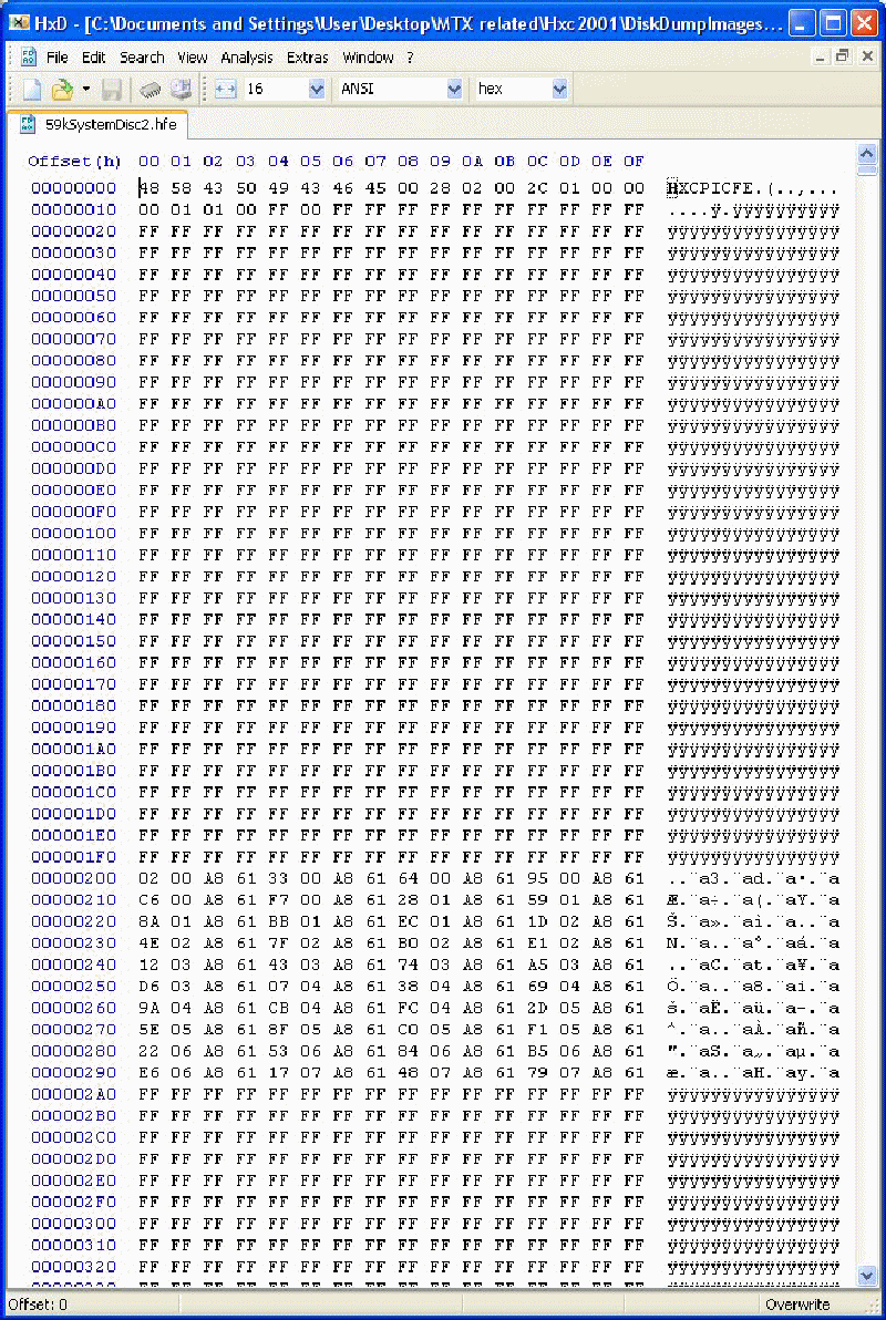

Got the editor, attached a screen shot as I cannot see how your refs above tie in with what I am looking at on the screen. Not used anything like this before, sorry.
Re: Help with Memotech MTX disc format
anvil1man wrote:Got the editor, attached a screen shot as I cannot see how your refs above tie in with what I am looking at on the screen. Not used anything like this before, sorry.
You must change 0x2C 0x01 to 0xFA 0x00 in the first line...
