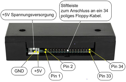

Jeff wrote: Thu Aug 01, 2019 5:28 pm you can try is to set to "High"
I mean : in the interface cfg -> custom ->pin 02 -> set it to "High".
Below you can see where is the pin 2 :
Re: Emulator on Yamaha Clavinova
There is maybe a custom setting to try before playing with the wire :
- Pin 02: nDiskChange 1 (Head step only to clear it)
- Pin 34: nReady
