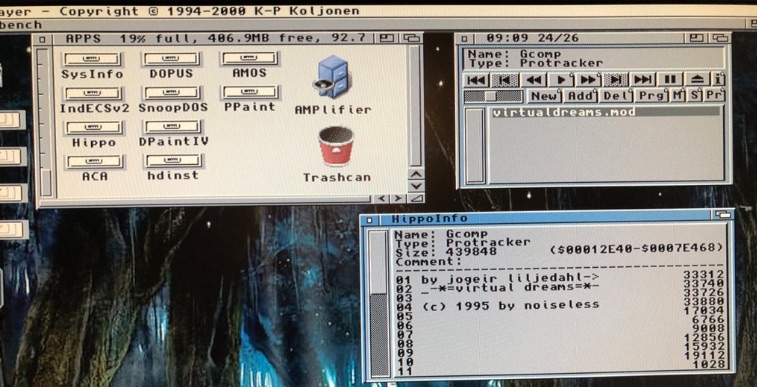

ljmarent wrote: Tue Jul 05, 2022 1:43 am I also gave this one a try...
Flashed the new firmware
Put a fresh copy of empty.adf on the stick
Copied the same MOD file to this empty.adf
It actually loaded into HippoPlayer without errors this time, but playback is messed up
here is the empty.adf that was created with that one MOD file written
empty.adf.zip

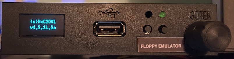

Q1) Are you sure you have updated the firmware ?
I'm pretty sure this is being done correctly, I'll go catch a photo
latest update.jpg (74.27 KiB) Viewed 34167 times

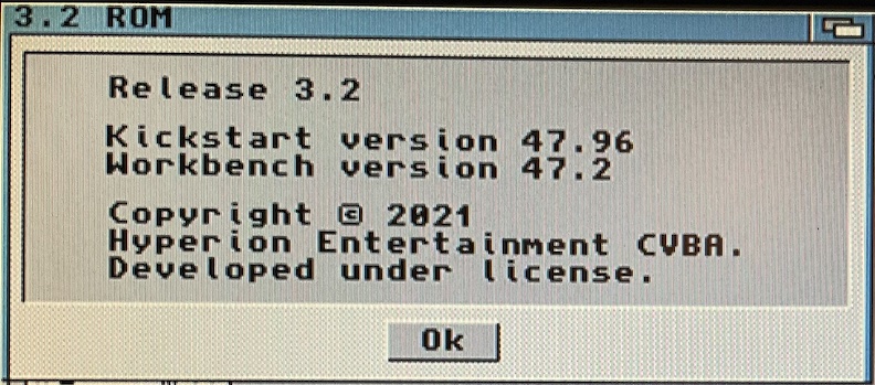

- Amiga 2000 rev 6.2 motherboard, ECS Denise, ACE2b (PAL mod)
- TF536 (SwissBit 4GB SLC CF) + ZZ9000 RTG
- OS 3.2 WB 47.2 KS 47.96
- Gotek Floppy, OLED, Rotary Encoder (AmigaStore.eu) (fw v4.2.11.2a) (SwissBit 1GB SLC uSD) DF0:

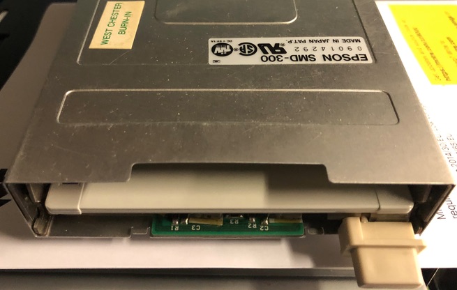

As a further check of my A2000 hardware...
- I pulled an Epson SMD-300 mechanical floppy drive out of my box of stuff and installed it as DF0:
- I put a brand new 3M DSDD disc in the drive, and powered up the A2000
- Formatted the floppy
- Copied the MOD file to the Floppy
- Used Hippo to load the MOD file from the floppy
Plays perfect, no corruption
