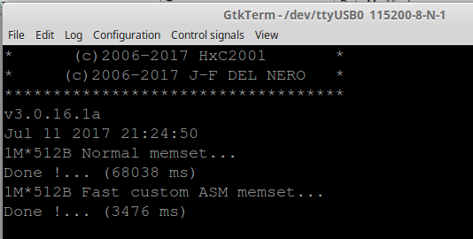

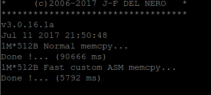

- libc memcpy/memset and some others functions replaced by my assembly versions to obtain some severe code speed-up ;)
:wink:

Yes: Bad memory alignment crash at in FM write mode...
Fixed :
https://hxc2001.com/download/floppy_driv ... aTrial.zip
Thanks for the feedback.

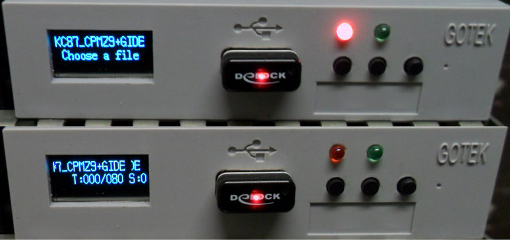

8 August 2017: Firmware STM32 USB HxCFloppyEmulator v3.0.21.1a
- LCD Display : Refresh rate adjusted and I2C dead lock issue fixed.
- Normal / direct browsing  mode :
Auto selecting the current image or subfolder if you don't
press the buttons during than 4 seconds. If needed, the file name
scroll during the delay time.
This modification make the additionnal select button optional.
Of course the LCD still needed for this mode.
- Indexed/selector mode :
Delay added before selecting the image. Browsing through the slots
is smoother. If needed, the file name scroll during the delay time.
- 7 segments display :
  New error/message codes :
  "FAt" : Fat init error.
  "NFL" : No file. Empty stick ?
  "CFG" : Config file not found !
  "cFG" : Bad config file !
  "Nor" : Warning -> in Normal/Direct browsing mode. You should use a LCD screen.
  "AUt" : Autoboot.hfe not found.
  "Err" : File image error !
  "Ldr" : Into the bootloader.
- Config file save : Before writing to the disk, check that this is really needed.
                     (Parameters change check)
7 August 2017: Firmware STM32 USB HxCFloppyEmulator v3.0.20.1a
- Low level I2C & LCD IO redesigned and optimized.
- Long names are now scrolling on the LCD during floppy emulation.
- Short name image type identification issue fixed.
- USB "Hot plug" support fixed in autoboot/"file selector" mode.
4 August 2017: Firmware STM32 USB HxCFloppyEmulator v3.0.19.2a
- New buttons behaviour and better debouncing filter. Navigation user-experience should be better now.
- Disk Eject function : Press both buttons to eject the disk. Working in indexed, autoboot mode, and normal mode.
- "Eject at power up" option added.
- Support up to 999 Images in autoboot mode (with the File selector) (Use the new CFG file and selector to use this feature)
- LCD : Display refresh improvements.
- New CFG file format : Some new flags and no more slots/disk drive limitation.
- Some critical parts rewritten in assembly. Huge code speed improvement -> Better HD density reliability. ED density to be tested ;).
- Code size reduced.
- Advanced USB mass storage cache implemented to improve read/write reliability.
  (Btw : Now when track size can be stored into the SRAM, the emulator will not read forever the data from the stick but use the cached data instead).
- IMG/ST file write support done.
- Huge RAW (*.ADF/*.ST/*.IMG) Write performance enhancement (Write 2 tracks at once !)
- RAW *.IMG files can be used in indexed mode : Name the files DSKA0000.IMG,DSKA0001.IMG,DSKA0002.IMG,...
- HFE write performance enhancement.
- "Autoboot.hfe not found" message added.
- 7 segments display "dots" glitch fixed.
- 128 & 256 bytes sectors support added in raw mode.
- FM support : Write to HFE file fixed.
- FM support : Raw (*.dsk) read/write support.
- New File format support (WIP) : HFEv3. Can now support copy protected images converted from IPF and others similar formats !
  Variable bitrate supported (CopyLock & SpeedLock). Weak/Flakey bits support to be added !
- Fix IPF support for these games: Jim Power, Z-Out,Xenon 2,Ghosts'n Goblins,Rainbow Islands,B.A.T II  and probably some others !
- Slot number printed on the second line during slot search with an LCD.
- XCopy write issue fixed.
- Sound buzzer output on the "JB" jumper position. You can connect a piezo or a magnetic buzzer (transistor needed for the magnetic version).
  The sound output can be disabled or enabled into the selector settings.
  (Note : Please remove these old sound mod using directly the step signal, they are producing reliability problems...)
- Mixed track format/density write support fixed (To be tested!).
  Current direct images support : *.HFE (RW),*.HFE V3 (RW) (early write support), *.ADF (RW), *.ST (RW), *.IMG (RW).
  Note : HFE files is a multiplatorms floppy image format supporting many systems and disk formats.

at v3.0.21.1a there is a problem with the OLED display mod. After selecting the file (by push-button or automatically), there are errors in the first line. Can you correct that please?
And the blinking second LED is annoying with scrolling text... :shock:
