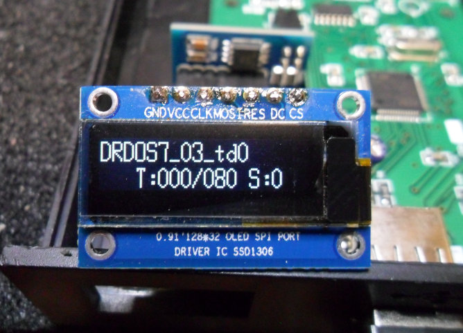

Kingstener wrote:ooh, it looks strange... :shock:
- 0.91" OLED 128x32 with SSD1306 driver ?
- Fuses from readme?
- R/C on reset 1000nF/27K? (if it is a SPI display)
- VCC 3,3V ?
Swap of SCL / SDA brings nothing to fry :wink:

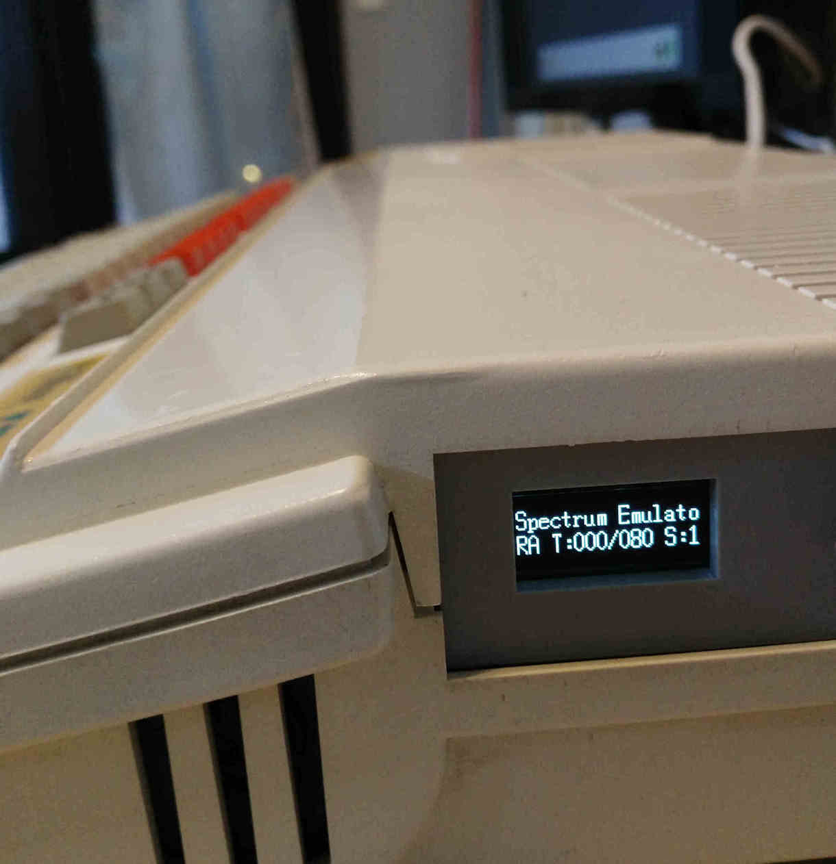

Thank you for the help!
i ordered 128x32 OLED... i am not sure the chinese store send me a 128x64 instead...
fuses ok, i2c one, but.... i used 5v for VCC, since i swapped for testing the OLED with the LCD display!!!
May be it's the overvoltage had fried the oled... :roll:
Kingstener
Posts: 67
Re: OLED mod
Post by Kingstener »
No, this also works at 5V, but it can be the reset does not work properly.
The resolution should be printed on the display

Kingstener wrote:No, this also works at 5V, but it can be the reset does not work properly.
In the I2C one's is only printed 0,91 oled... :(
I tried with 3,3v, with no change... but it's probably too late, and display is gone.
I'm waiting for a new one, arriving in a few days. Thank again for your support!

I guess at 0.91" is the a maximum resolution 128x32 pixel

solved...
the display was fried... arrived new oled and now all ok!
thank Kingstener for the patience! :)
