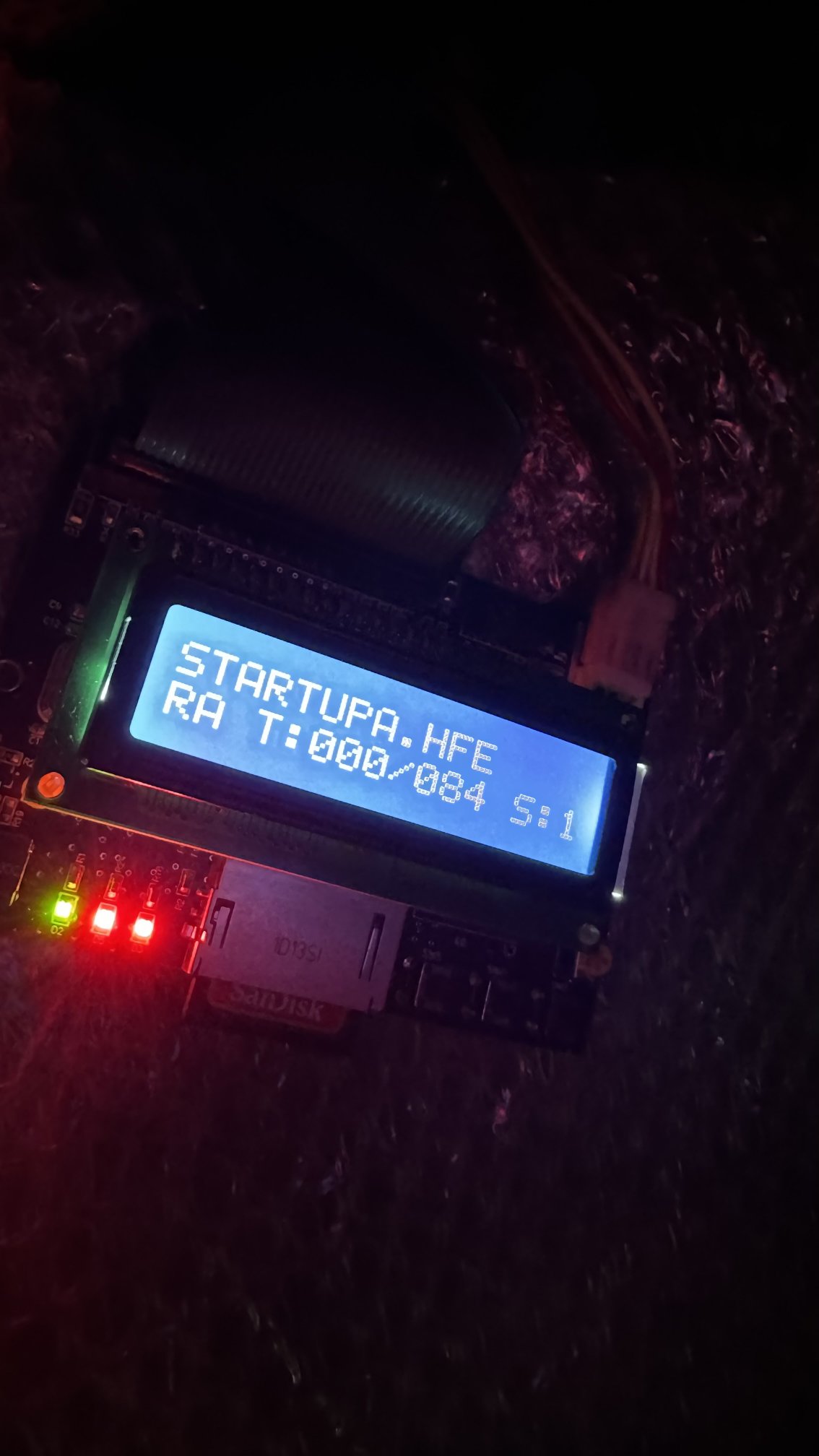

DAVE11674
Joined: Fri Sep 08, 2023 5:42 pm
Re: Sega System 24
Post by DAVE11674 »
hi guys i purchased one of these
put a 32gb sd card with the above STARTUPA.HFE on the root
upon boot up of the 4 player hotrod
i just get whats shown on the pic
no loading/ticking noise of loading tracks...
is there any other setup i need to do ?
should there be more files on the SD card ?
i have 4 x jumper settings too
not sure what these need to be setup to ?
i think i just need drive A - ID0 jumper set and nothing else ?
can anyone help a guy out please :)
Re: Sega System 24
DAVE11674 wrote: Wed Jul 24, 2024 10:10 pm can anyone help a guy out please :)
Try to reconnect the floppy ribbon upside down.
DAVE11674
Re: Sega System 24
Post by DAVE11674 »
Just tried mate
Still sits on the now loading screen
And floppy emulator shows
STARTIPA.HFE
T:000/084
And just sits there
Not sure should i be changing
Interface.cfg with the sd card out ?
Its currently sat on SHUGART !
Ps jumpers i have only 1 on
Drive A id0
Not sure if these are correct too
Thanks jeff for your response, hopefully we can get this running :)
dave
EDIT
i needed it set to drive A ID1
Thank jeff for the files and help
