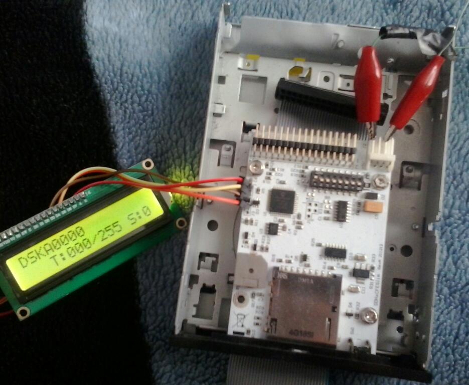

Thank you for the beta. It works for me too, I did a quick test.
Now I have to figure out how to fit the lcd and the hxc-slim in the case together... At least the height of the space for floppy drive on the ensoniq sd1 is higher than usual.

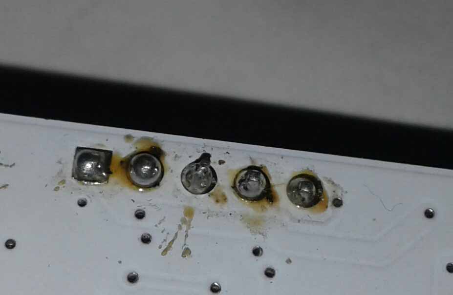

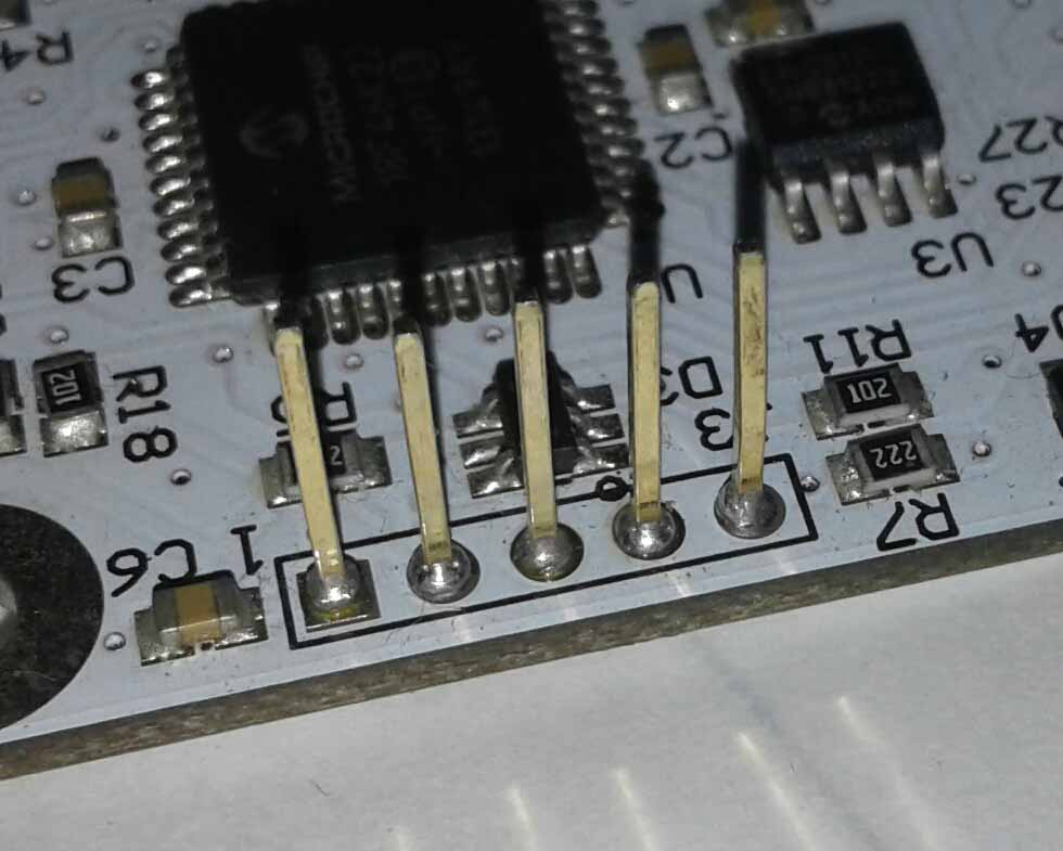

Hi.
Try to put the display on my slim ReVA. FW 2.1.6.14
But I can not get the display to show characters ..
The display is fine. the floppy tamabien. the only thing he does is turn on the light. when I activate floppy functions.
Any ideas? Thank you

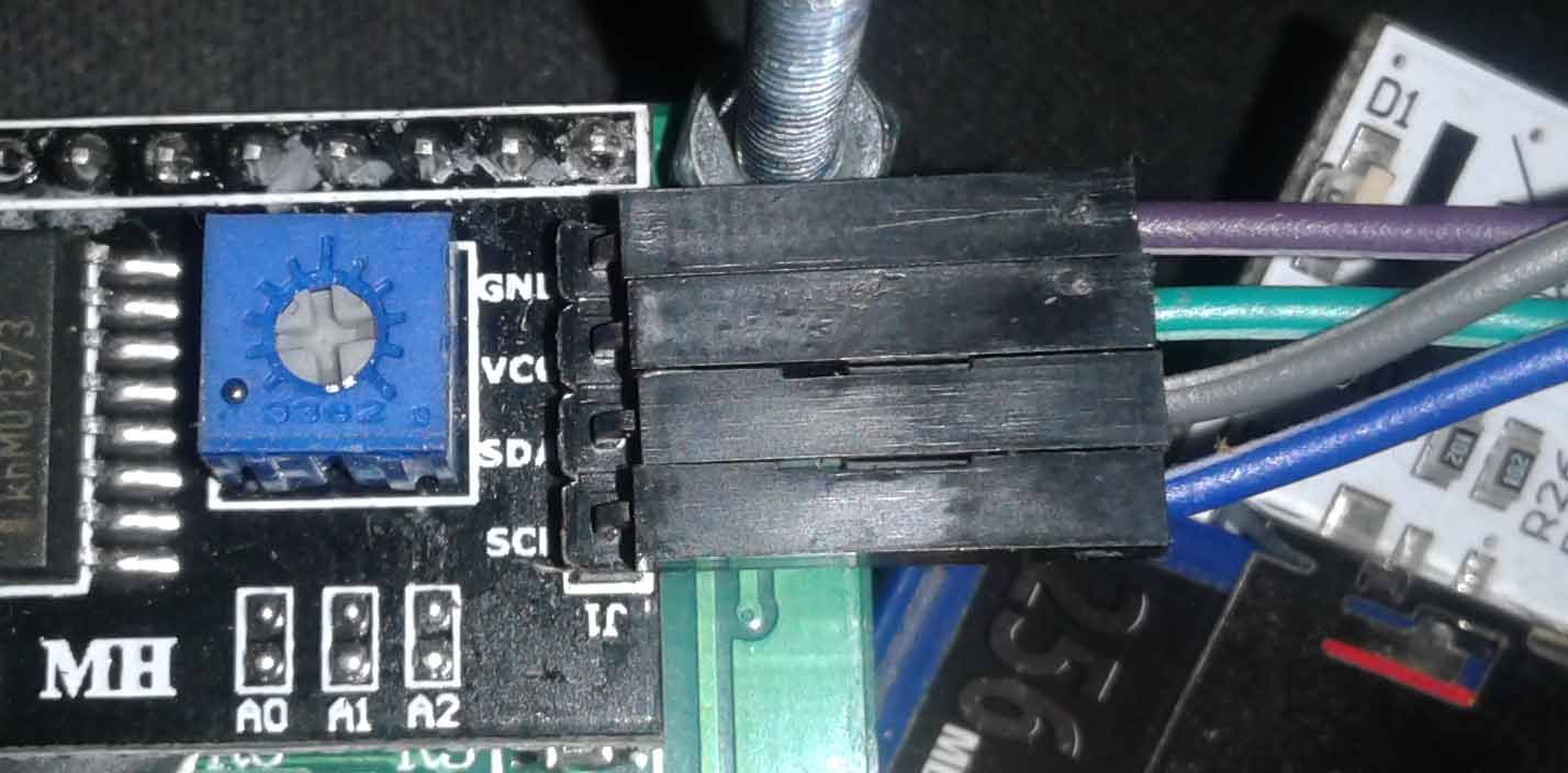

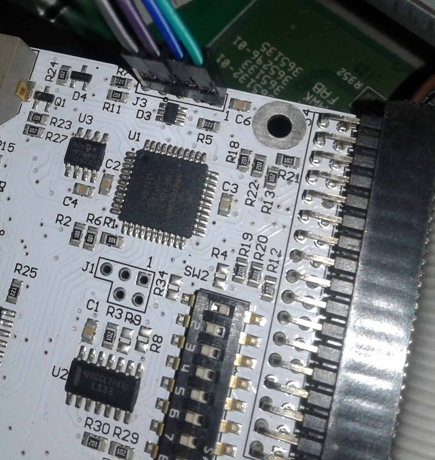

Can you share a picture of your connections ?gabrielg wrote: Fri Jan 26, 2018 10:23 am Hi.
Re: New Slim/cost reduced SD HxC Floppy Emulator !
the plastic remove too see pins
- 20180126_195517-1.jpg (72.58 KiB) Viewed 47438 times
- 20180126_195524-1.jpg (32.65 KiB) Viewed 47438 times
I mean with the connections wires to the screen.
- 20180128_194001.jpg (178.67 KiB) Viewed 47381 times
- 20180128_194016.jpg (90.56 KiB) Viewed 47381 times
