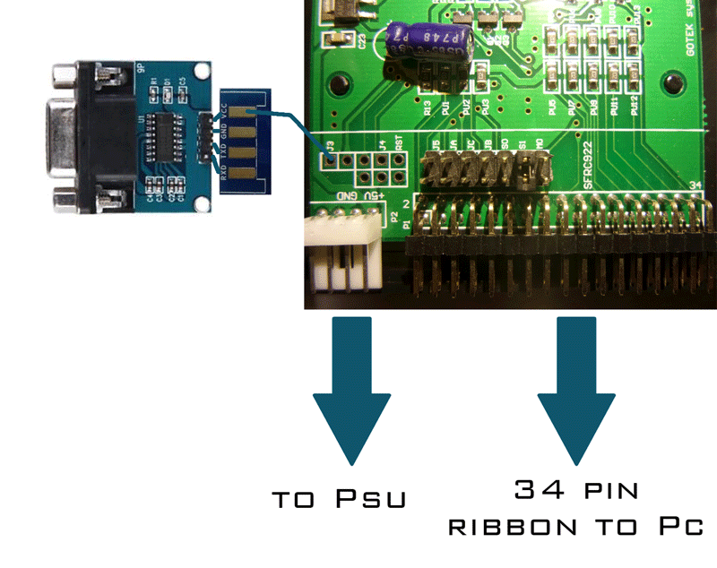

Please, can anyone help me to understand connection?
-> Connect your serial adapter to the device and to the PC. (GND,RX,TX,+5V)
Note 1: To power the device, you can use a external +5V source or the +5V coming from your USB adapter.
Note 2: Cross connect your serial adapter to the device : TX wire to the RX pin, RX wire to the TX pin.
VCC to J3: OK
Then.... Where are RX TX GND etc on the GOTEK FDD EMU? :?:
could someone draw the right links over the image? so that it is fool proof. :wink:
Thanks Thanks Thanks Thanks Thanks Thanks

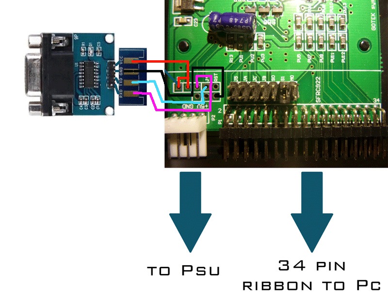

Re: GEM S2/S3 and Turbo models
Here it is :
Mapyx
Posts: 12
Joined: Sat Jan 05, 2019 11:42 am
Post by Mapyx »
Awesome! Thank you :D
