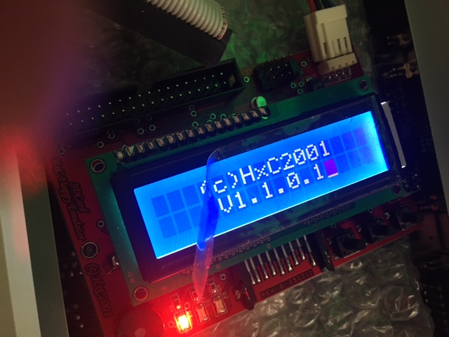

telengard wrote:I updated the firmware but for some reason can no longer use the device on my ST. Is there more that needs to be done, i.e. did the hfe format change, the config file format change, etc?
I have HxC with firmware 1.1.0.1... i have problems to update it... I see hear that pre 1.2.... versions need a bootloader to be updated prior to firmware upgrade... pls can you help. I have already bought new SDHC card, used freshly formated FAT32... the result seems to be the same.
Many thanks.
P.S. The HxC is connected to Sinclair QL
Re: New Firmware version for the SD HxC Floppy Emulator (B/C
Bootloader sent by email.

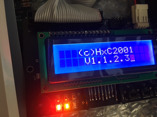

Hello Jeff
I have same problem like atarimike
My emulator is from 2010 and it is fleshing 5 times when I try make update
sd cards are fine I have few of them and they are working
Would you please help
Thank you
mhhh wait... You didn't update your emulators since 5/6 years and you want to jump to the current version ?
This sound to be a bad idea. Why to you want to update such old firmware ?
BTW the current version doesn't work on earlier boards without some hardware modification, please see the release notes for details.
Anyway if you want the update, please send me an email.

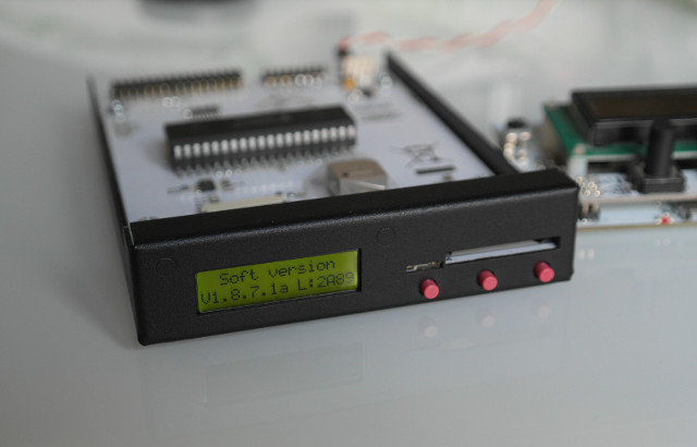

Re: New Firmware version for the SD HxC Floppy Emulator (B/C/F)
New Firmware version for the SD HxC Floppy Emulator (Rev B/C/F/MAX) :
SDCard_HxCFloppyEmulator_firmware.zip
sd_hxc_floppy_emulator_firmware_release_notes.txt
25 February 2021: Firmware SD HxCFloppyEmulator v1.8.7.1 (beta)
- "Config-Less" support : The HXCSDFE.CFG file is now optional.
You can now use the emulator without this file on the SDCard.
Note 1: Without this file the emulator is in "normal mode" / direct
browsing mode.
Note 2: Without this file the last selected file position is not saved.
Reminder : You can setup the emulator with the embedded menu without
the need of any configuration file :
To access this menu, remove the SDCard and press the select
button. Once in the menu you can choose the option you want
to change.
- System and hidden files and folders on the SDCard are now invisible on
the emulator. You shouldn't be annoyed anymore by non-HxC folders and
files on the emulator. :)
- Image auto-load disabled when the user press the left or right button :
-> Faster SDCard browsing, More consistent browsing behavior.
(On this point if you prefer the old/previous behavior, don't hesitate
to contact me to let me know : hxc2001 at hxc2001.com)
