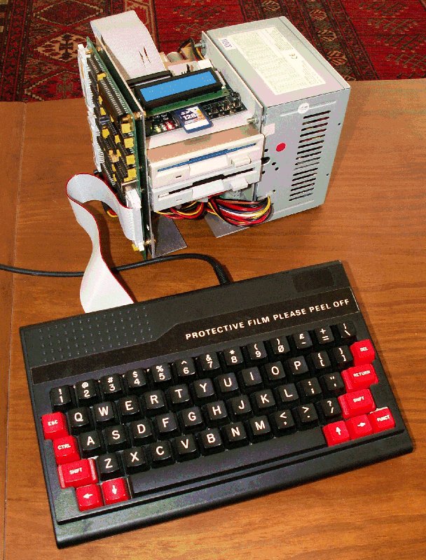

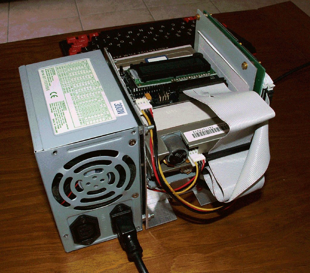

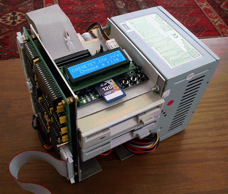

please find below photos of HxC (drive A) connected with real B and C drives. I need to screw the HxC on the chassis.
The flat 34 pins cable (between controler and floppies) needs - if you do not have jumpers on your floppies - :
1) for drive A : to turn 9 to 13 wires, to cross 10 and 12 wires (9, 11, 13 are ground, so easy to realize).
2) for drive B : no wire to cross.
3) for drive C : to turn 11 to 15 wires, to cross 12 and 14 wires.
Oricordialement,
Thierry

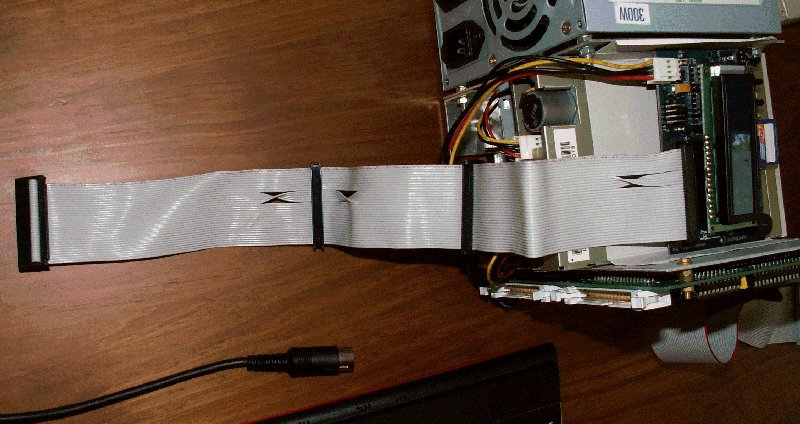

here is a photo of the flat cable to connect Oric Disc Controler to floppy drives (remember, disc drives with no jumpers to setup drive to A, B, ...).
Connectors from left to right :
- Oric disc controler (Microdisc, Cumana2, ...), Drive C, Drive B, Drive A.
Remark: from Oric motherboard to Oric Disc Controler: simple straight flat 34 pin cable (no turn of wire).
Hope that help you
Thierry
