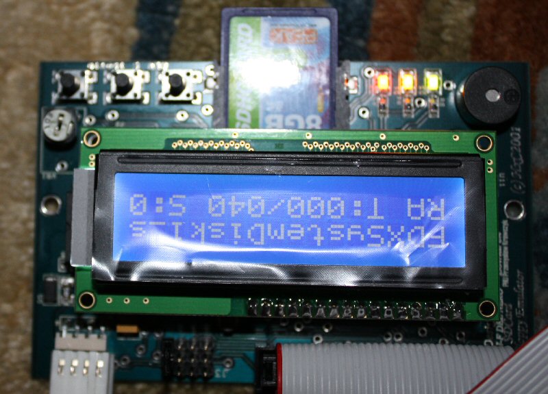

What jumper setting are you using ? Can you make a picture of the floppy emulator ?

Hi, not sure what you mean by a picture. Are you wanting me to take a photograph of it connected to the MTX FDC?
It must be right on the jumper as when the MTX tries to boot from disc the disc light comes on on the Hxc2001. Then it either goes off after a few seconds or stays on.
Jim
Re: Help with Memotech MTX disc format
anvil1man wrote:Hi, not sure what you mean by a picture. Are you wanting me to take a photograph of it connected to the MTX FDC?
Yes exactly.

Ok, here it is:
anvil1man wrote:Ok, here it is:
mmhh i don't see were is exactly the jumper :?

Attached a photo of where it is connected, if that helps?
anvil1man wrote:Attached a photo of where it is connected, if that helps?
ok.
Is the computer trying to step the head ? Which track the computer is trying to read ?

watching the LCd during the attempted boot process the numbers do not change at all. The only thing I can say is when the MTX tries to access the disk the middle (drive access?) light comes on so am assuming this is its attempt. Other than that there is no noise to suggest any stepping is happening. On the real 5,25" drive if the disc does not contac a boot block it will not try and step the motor either, if that helps?
