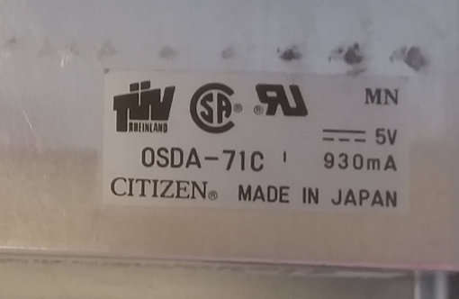

Re: Acorn A3000
please tell what was the old disk drive model and brand.
Samy83
Posts: 5
Joined: Sat Sep 10, 2016 4:55 pm
Re: Acorn A3000
Post by Samy83 »
It was a TÜV CITIZEN OSDA-71C
Re: Acorn A3000
I found nothing about this drive. Is there any jumper on the drive ?
