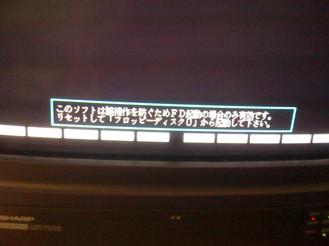

With Nemesis 90 Kai, everything seems loading without problems and finally i've got this error message:
HELP! :)

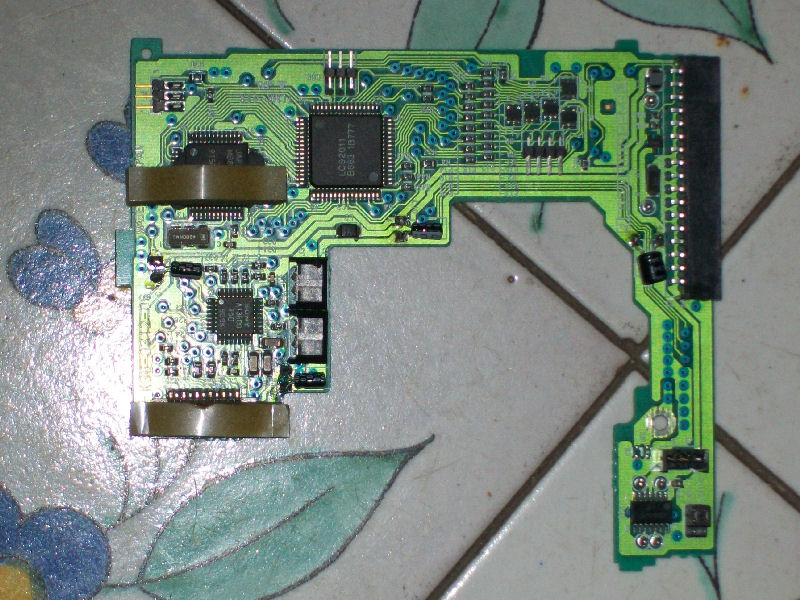

Yes but keep in mind I have a X6800 CompactXVI which has different floppy (it has 3.5" with soft eject feature) from other model but I think signals are the same in all models.
I have two faulty floppy drives, if you want I can send you them for studying.

Can you take some high resolution pictures of the pcb ?

Ok, tomorrow I'll take and send you some high resolution pictures, for now I have only this:
X68000 XVI Compact floppy PCB.JPG (163.5 KiB) Viewed 63771 times

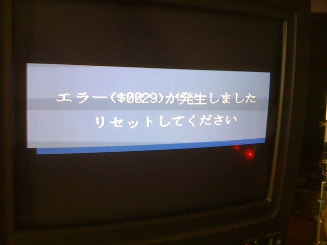

Jeff> i see "RA" on the LED screen
I've tested many games that should works on X68030, but with the HxC they don't...
Nemesis 90 (error screen... if someone know how to install it on HDD?)
Akumajo (black screen, nothing happen... if someone know how to install it on HDD?)
*****edit*****
error message when i use the hdinst utility on the second floppy
Cotton (refuse to start directly on floppy, need to be installed but it's not working...)
Dragon Spirit (error screen)
I don't know if the problem comes with the floppy images ...
