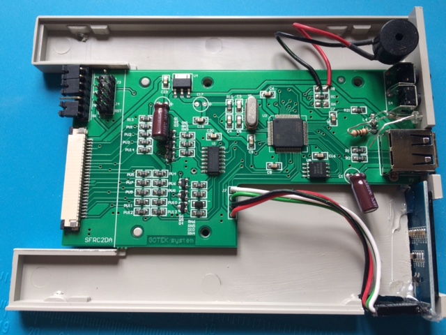

mikeyp wrote: Tue May 21, 2019 8:17 pm Hi Jeff
I've just swapped in the OLED display which as you can see works flawlessly, however it does cause an odd issue, once initialised the red error LED stays on constantly. The green access LED works as normal.
If I swap back in the 7 segment display, it works normally, off most of the time and lighting red when I press a button etc.
Is this a bug in the firmware or something the OLED is causing?
Thanks again
Michael
Not a software bug, but a strange thing in the gotek hw design : the "error led" is mounted as pull up on one of the screen i2c bus signal.
Since the oled is constantly updated, the red led is lit constantly too.

Ooh ok. That is odd. I presume it's safe on this model to remove the red LED then? Some 34 pin models don't seem to have it. I have one with it but folded back internally and two without.
Re: Slimline gotek drive hardware configuration
mikeyp wrote: Wed May 22, 2019 10:42 pm Ooh ok. That is odd. I presume it's safe to remove the red LED then?
not sure : if you remove this led, this also remove the pull up.
you may need to replace it with a 1Kohms resistor.

R21 is already 1K to the common anode of the LED. Are you suggesting bridging it with another 1K resitor or just relying on the existing 1K resistor?
mikeyp wrote: Wed May 22, 2019 11:10 pm
Jeff wrote: Wed May 22, 2019 10:58 pmnot sure : if you remove this led, this also remove the pull up.
i recommend to bridge it with another 1K resistor. the r21 is common to both leds.

I de-soldered the red leg of the LED and bridged the connections with a 1K resistor as you suggested. This seems to work just fine. I didn't try it without.

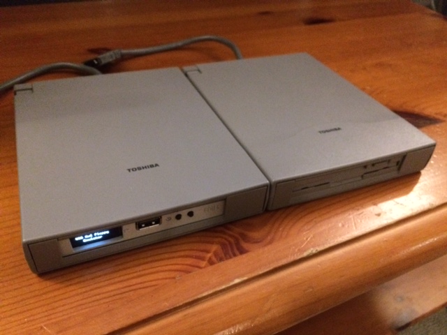

This is the completed unit with OLED screen. I've left the leg floating in case I wish to reconnect it in future. There's no risk of it touching anything. I've also re-removed resistor RA so I don't need custom firmware.
Here's the finished unit next to an unmodified floppy drive version. All I need now is to find some suitable grey plastic, cut to size and cut the holes and fit it to blend in and keep the original aesthetic.

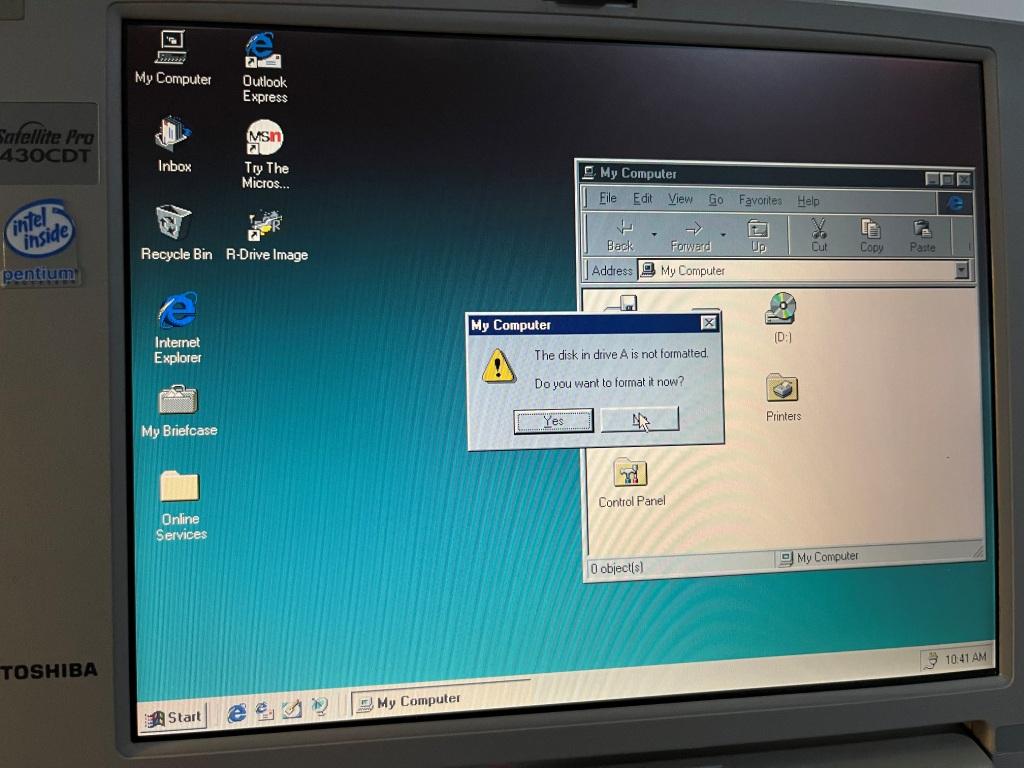

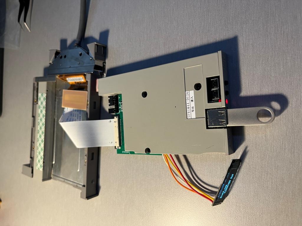

I have the same Gotek slimline (SM32F105) and the same case from Toshiba Floppy disk. I’ve remove resistor RA , RB , Jumpers S1, JD and JE connected , used the menu on the drive to set the function of pins 2 and 34 to nDiskChange1 and nReady - "Disk in drive A is not formatted"...
Does anyone know a solution to this problem?

It’s been a long time since I worked on this so my memory of it is vague. Your laptop is newer than mine. It is possible it is expecting standard signals. Have you tried with standard menu settings and then switching each of those in turn individually to see if that helps? Beyond that I can’t offer any advice about your machine but I’m sure Jeff will be along soon.
Bvalrs
Posts: 5
Joined: Tue Sep 26, 2023 7:19 pm
Post by Bvalrs »
Thanks for the answer ,
I tried all combinations of settings and different firmware, and on different laptops (these floppy disks were suitable for a large number of Toshiba laptops).
With other settings different from yours, the disk was not detected at all.
p.s. My laptop is Toshiba Satellite Pro 430, 1995, not very new.
