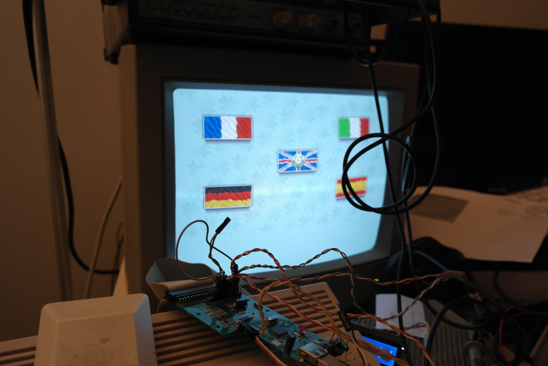

Re: How i can Writeprotect Image and other problem.
Tried here, and it is working !
Have you set your jumper to "S0" or "S1" ? This doesn't work if you set it to "MO".
Is your drive connected to the internal floppy connector ?
Can you retry with your accelerator board disabled ?
EDIT !!! : I have reproduced the bug : By immediate launch (F7 key) this is working, not by setting the slot. Will fix the selector !
