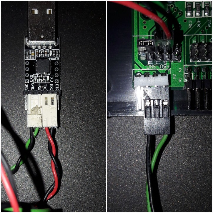

Seems fine.
Try this : start the software, open the serial port, connect.
If after some seconds the gotek is not detected try to make a contact between GND and RST to reset the gotek. wait again some seconds.

Shall I disconnect the power before and the tx and rx cables?
Re: Korg T3 data error
No no, do the reset procedure while all is up and connected.monolight77 wrote: Thu Mar 01, 2018 2:26 am Shall I disconnect the power before and the tx and rx cables?
don't make a permanent connection between GND and RST. One second is enough.
btw what is displayed in the "TX" & "RX" fields in the flasher software ?

tx moves from 0 to 10
rx is always 0
I have discover a blown up voltage regulator in the Gotek. Maybe I made a bad power connection at same point. I will change it and come back.
rx is always 0

Good morning Jeff,
Back again! Wish you could help me....
Gotek connected to computer, not receiving instructions from the hxc soft.
Resetting (gnd/reset shortcut) makes no difference.
When connected to my Korg T3 it acts normally. Recognises pen drive and makes the partitions.
Only thing is trying with another computer but I only have W10 in all!!
Can I install the soft and enter my password in several computers to try? Or this is going to be block by your server?

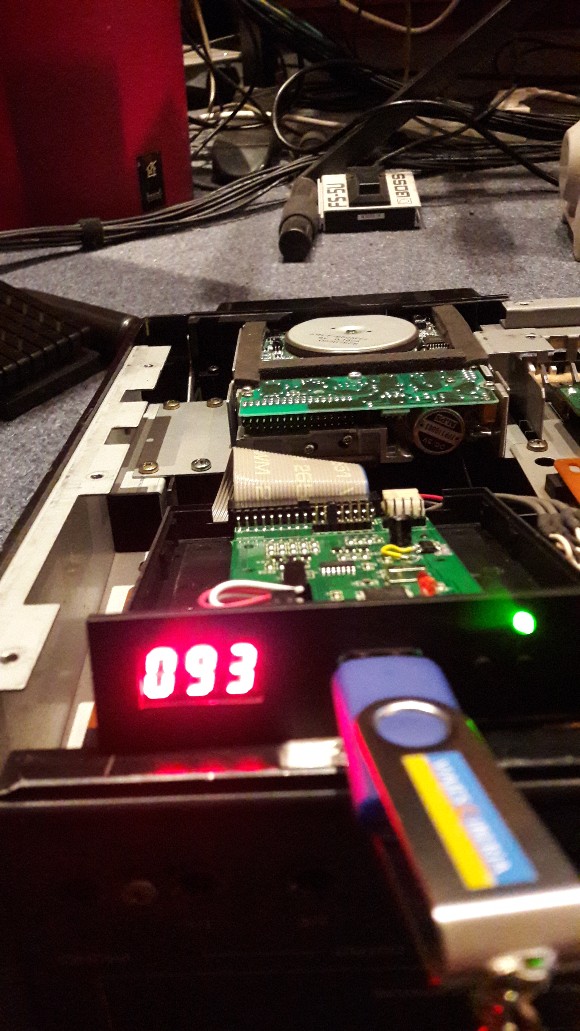

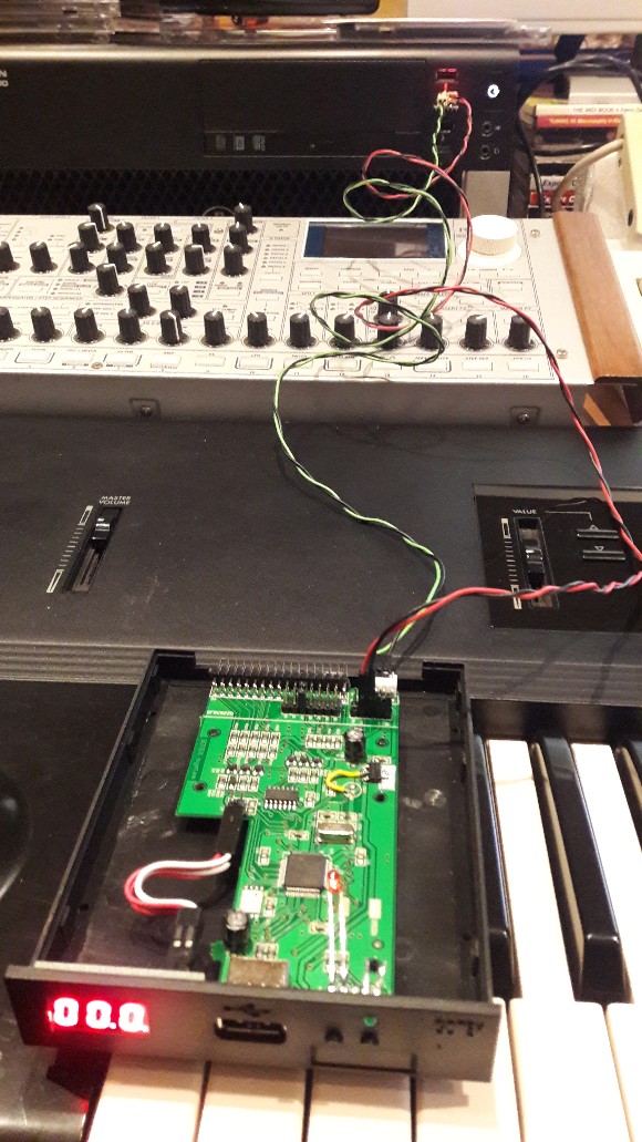

- 20180309_105143-580x1031.jpg (159.86 KiB) Viewed 10380 times
- 20180309_100842-580x1031.jpg (168.51 KiB) Viewed 10380 times
no, no problem you can.monolight77 wrote: Fri Mar 09, 2018 12:05 pm
Btw the last picture is interesting : in flashing mode the screen should be off. Are you sure that the BOOT0 strap is correctly soldered ?
if rx is always 0 then there is a problem : the gotek don't answer - check the boot0 strap and the connections. You can also do a loopback test to check your usb adapter : connect the rx and tx signal together without the gotek. if tx and rx increase together then this is ok.

If I connect the Gotek to the serial and then to the computer, the display is black.
If I connect it without the BOOT0-VCC3V3 strap it lights. After this I put the jumper: that is why in the pics the display shows 000.
I have double check my soldering of the BOOT0-VCC3V3 stripes and is ok.
If I connect only the serial adapter to the PC, start HxC utility, open COM1, make a shortcut between the serial rx and tx and hit "connect" , tx varies but rx not.
no, you need to put the jumper before powering up the gotek.monolight77 wrote: Fri Mar 09, 2018 1:33 pm If I connect the Gotek to the serial and then to the computer, the display is black.
This is not good at all. you need to "fix" this. Are you opening the right com port ?monolight77 wrote: Fri Mar 09, 2018 1:33 pm If I connect only the serial adapter to the PC, start HxC utility, open COM1, make a shortcut between the serial rx and tx and hit "connect" , tx varies but rx not.

Done!
My Gotek is flashed with HxC firm and installed in my KORG T3.
Whn I switch on it reads "Ldr".
Now trying to make it work...
Thanks Jeff!!!
Thanks Jeff!!!
Well done ! Now just copy the latest firmware upd file to the root of the usb stick.monolight77 wrote: Fri Mar 09, 2018 6:40 pm Done!
