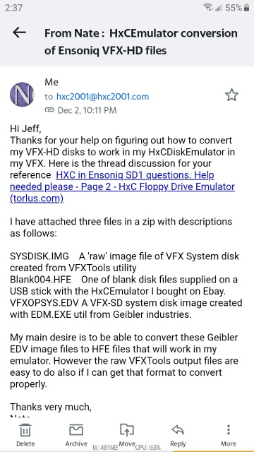

I downloaded the attachments and will try the things you said. I did try one of the HFE files on another USB stick and the drive didn't recognize it's existence on the drove at all. I wondered if it had something to do with the stick format being a different FAT than the FAT32 stick that was sent to me. I have attached a screen shot of the email I sent you the other day with a zip attached. I sent it to the email address you told me to use and it didn't come back undeliverable. Thanks.
