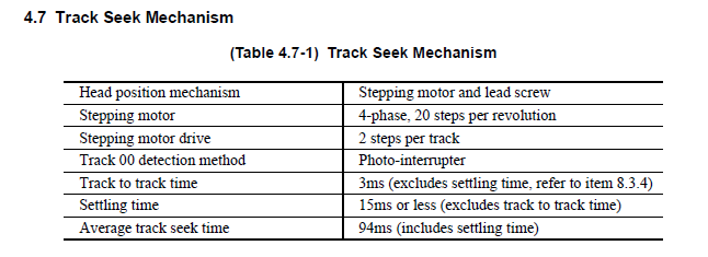

I will check it, but i suspect that you are making a settle time violation with these formats. ( not waiting the 15ms/18ms)
This may "work" with some drives, but for sure not with all.

So you confirm that you are expecting a settle time under 5/10ms ? in this case i am sorry but this is just not possible. A normal drive have a settle of ~16/20ms. Most 3"5 drive doesn't output anything during the settle time. Maybe that the cpc drive output something during the settle time.

Without these modifications, there is only 1.9ms between the sectors so this is well under the 16 ms head settling time, under the 3ms stepping rate, and under the 4/5ms hxc settling time.
The modified HFE have more than 4ms between the sectors.
FYI here some drives datasheet :
https://hxc2001.com/download/datasheet/f ... hirdparty/

i am pretty sure that 1.9ms isn't enough for a large kind of drives. If i got time i will make some videos to show you.
Anyway have a look to the datasheets.
