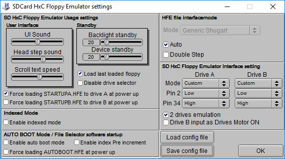

I'm having the same problem with my new HxC SD Slim, but changing the interface in the config file does absolutely nothing. I can set it on completely ridiculous settings and it still works but only if I switch dip #2 to on after the machine is turned on.
Re: Sega System 24
update the your firmware with the latest one.

To make it easy here is the config for sys24, this is assuming you want to start with the same image which you will need to rename to STARTUPA.HFE
