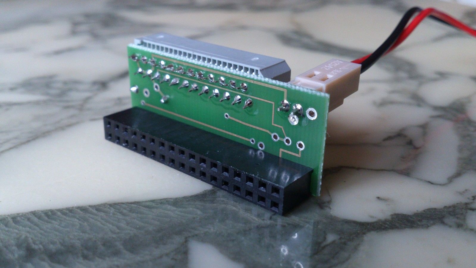

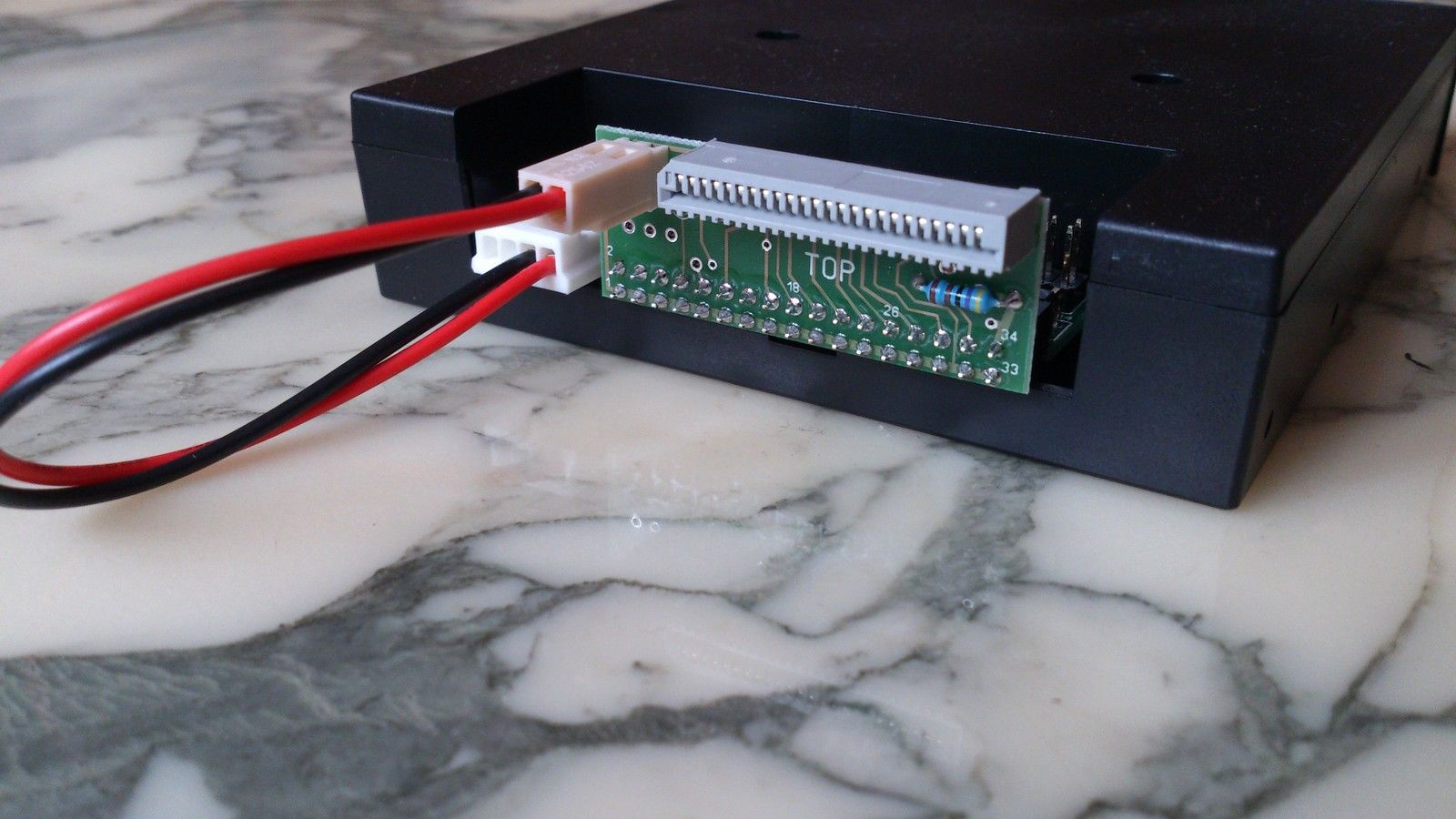

Hi all! My name is Roberto.
Last week I got my SFR1M44-U100k FAT32 USB Floppy Drive Emulator.
I wired it into a Technics KN 2000, which worked almost perfectly before the installation.
The Technics KN 2000 uses a PC Compatible 720KB drive with Special 24-pin connector.
I removed the old 720kb floppy reader that was damaged and i connected the emulator with an Adapter for Technics KN 2000 (34 to 24 pin ribbon cable). In that adapter pin 32 was connected to pin 9.
I turned on the kn2000 and the green light of the emulator and the red display are on.
The problem is, i can't get read the single 720kb partitions and the keyboard answer "Error00 THE DATA YOU ARE TRYING TO USE IS FOR ANOTHER PRODUCT"
The switch S1 is on with its jumper.
I tried to set the switch JA on , to generete READY signal on 34pin of floppy driver interface, but it doesn't work.
To test the adapter, i wired a 1,44 traditional floppy reader and it works perfectly.
Can you help me please ???

Hello, Roberto, I went through some of those problems and finally discovered there was a discrepancy on the wiring diagram. Pin 9 on the KN2000 should be connected to pin 32 of the emulator. When I made that connection, it worked perfectly. Please let me know how it works.
