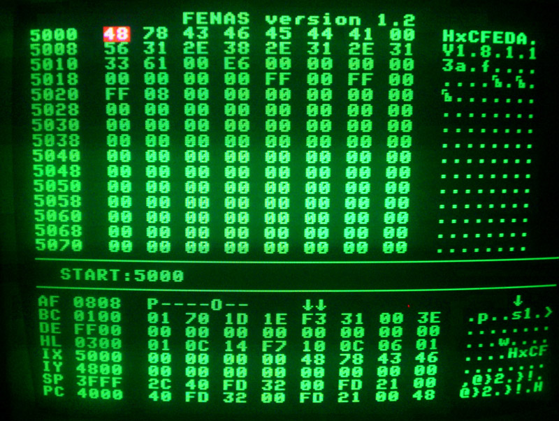

It is not too easy, because the track 255 can't accessed by EXDOS ROM routines (value 255 internaly used for mark "track position invalid, needed to be re set at the next access"). Then needed own WD177x routines.
But now track 255 accessed :D

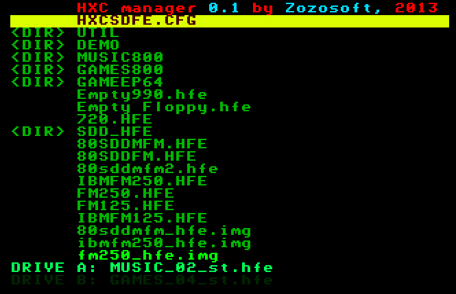

First target is a file selection software.
If I understood right the documentations, this is the task:
-enter direct access mode
-detect FAT32 partition
-list directory
-after file selected then search HXCSDFE.CFG
-write file FAT32 entry to the CFG file at 0x0200 or 0x240
-exit from direct access mode
All it is right?
Question about the partition: how the HxC find the partition on the SDCARD? Always use Partition Entry #1? Or scan all entrys? (Extended partition can be used?)
Both FAT32 (0x0B) and FAT32X (0x0C) types can be used?
The FAT32 partition only can be used with 4K clusters (8 sectors), or other values can be used?

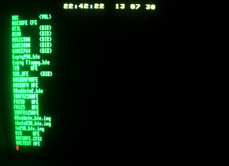

Root directory listed :-)

Now first beta version looks working, but I have more questions further developing:
Is exist a actual version of the CFG file specifications? The available about 3 years old then probably outdated :oops:
For example the firmware v1.8.2.24 added the index mode.
And "New Pin02/Pin34 Custom settings.", these are also stored in the CFG file?
At the Direct Access mode no values specified for these items:
unsigned char write_locked; // Write to the SD Card locked.
unsigned char keys_status; // Push buttons states.
unsigned char SD_WP; // SD Card write protect state
unsigned char SD_CD; // SD Card detect state
Which values used?
How can change displayed drive (A: or B: ) on the LCD? Only with onboard menu of the HxC? Or this setting also stored in the CFG?
Anyway I think will be a good idea add AUTO mode for this setting, when the HxC switch to the last accessed drive.
Is any way to ask SDCard size? If currently no, then possible in future firmware? For example add to the status sector variables.
About the Pin02/Pin34 settings, which Disk Change methods can be emulated?
It is possible emulate the old Sony method where the Disk Change signal reseted by Pin01?
Finally one new function proposal:
Save the last used directory to the CFG file, for example at 0x0280/0x02C0 similar as the selected images.
