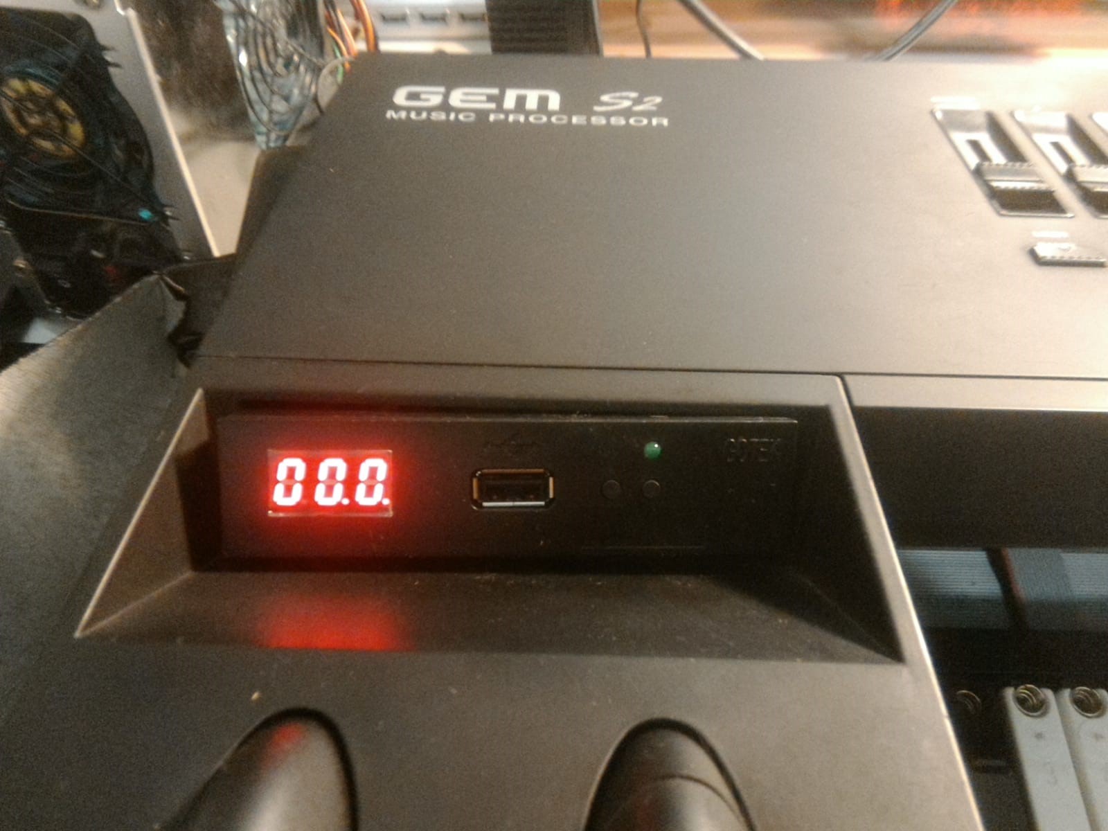

Re: GEM S2/S3 and Turbo models
hello, thanks for the quick reply, I was not hoping;)
Only 3 zeros appear on the display ... (I feel a little idiot with this answer)
where do I see the firmware?
Thank you so much
Thank you so much
- gotek.jpg (247.79 KiB) Viewed 17047 times

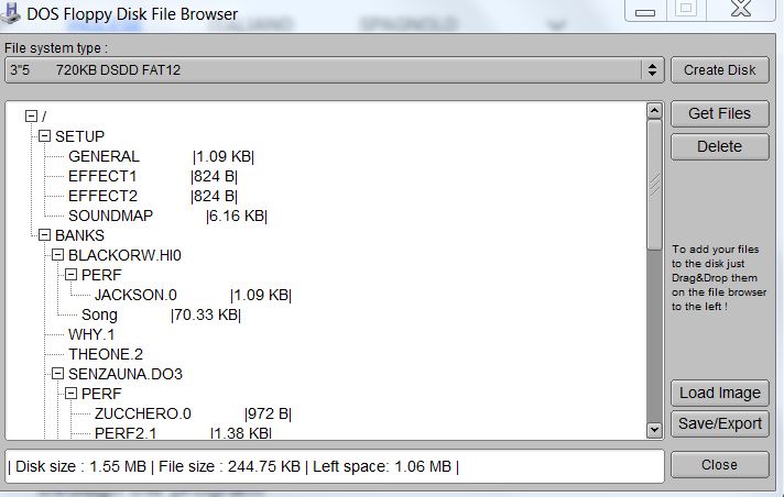

Testing.
I tried to format a USB pendrive in format
FAT
then
I inserted the files in the following archive:
SDHxCFE_GeneralMusic_GEM_S3.zip (Free browsing)
DSKA0000.HFE
DSKA0001.HFE
HXCSDFE.CFG-normal renamed to HXCSDFE.CFG
then
I opened the floppy disks images previously created with COPYQM through the program
HxCFloppyEmulator.exe (Windows)
LOAD IMAGE
it seems that the image is read correctly
then
SAVE / EXPORT
at this point I copy the files obtained 01.hfe; 02, hfe .... in the root of the pendrive
the GEM S2 however says DISK ERROR
where am I wrong?
FAT
then
DSKA0000.HFE
DSKA0001.HFE
then
LOAD IMAGE
then
SAVE / EXPORT
where am I wrong?
- Cattura.JPG (60.14 KiB) Viewed 17045 times
You don't have the HxC Firmware so the HxC tools and files will not work.
if you want to get the firmware : https://hxc2001.com/store
you need a tll usb serial converter to reprogram the device.

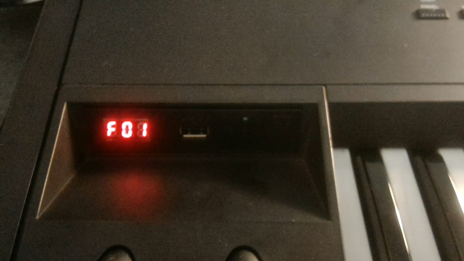

Firmware:
holding down both keys at startup are displayed in sequence:
U01
126
F01
U01
126
F01
- firmware.jpeg (83.99 KiB) Viewed 17041 times
