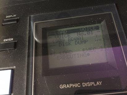

Ok, I emptied another drive (with fat32) and put some libraries on it which I renamed. Now the sampler freezes at "Executing", which is less than with the other flash drive. When I had the original floppy drive which didn't work I was still able to go to the menus etc.

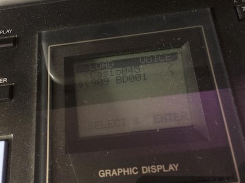

Loading... and nothing more happens

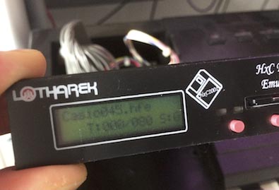

Screen while loading on the emulator

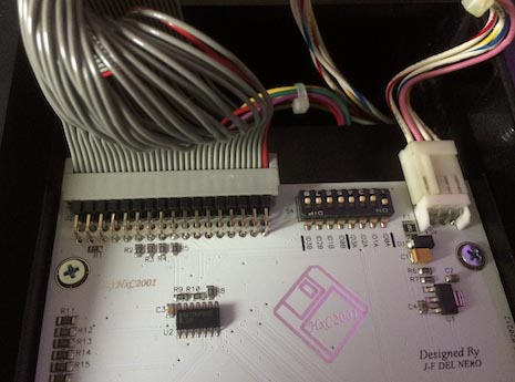

and the connections...
