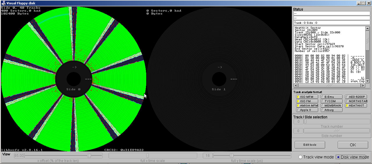

Further progress : Heathkit sector decoding :
:D

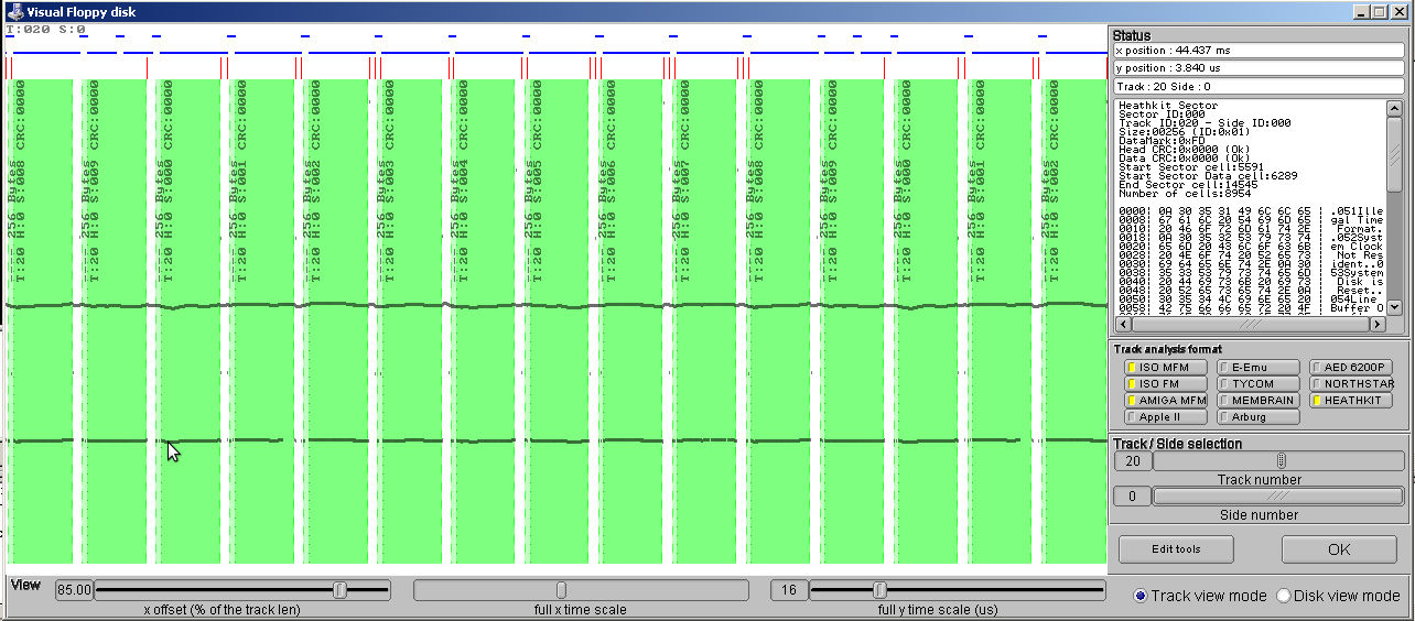

Re: Hard sector format
Have you checked the track/disk viewer ? This window show you how is the currently loaded disk. (Set the Northstar mode.)
Also : You must use the HFE V3 for hard sectored disks.
