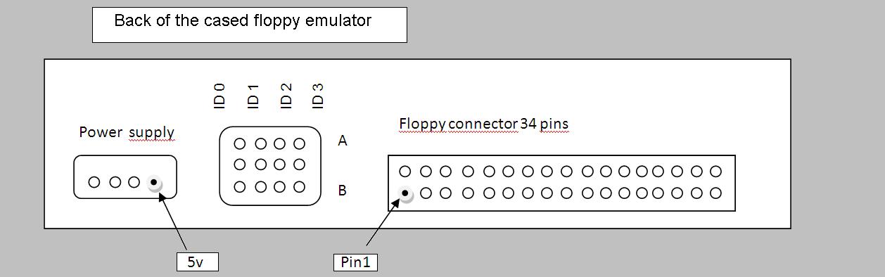

first of all - every user of cased version MUST REMEMBER that jumper pins are reversed - i mean upside down !!!
so, pins confirgation mu be be done according to this picture :
pins IN CASED VERSION to fitt in cased are angled, so according to offcial manual the order stays the same, but drives A-B are switched.
SD CASED.JPG (43.97 KiB) Viewed 4150 times

Do You have Your sd emul SET ID0 drive B ? floppy cable is not inverted
ps. please, post it back for test/ replacement.
