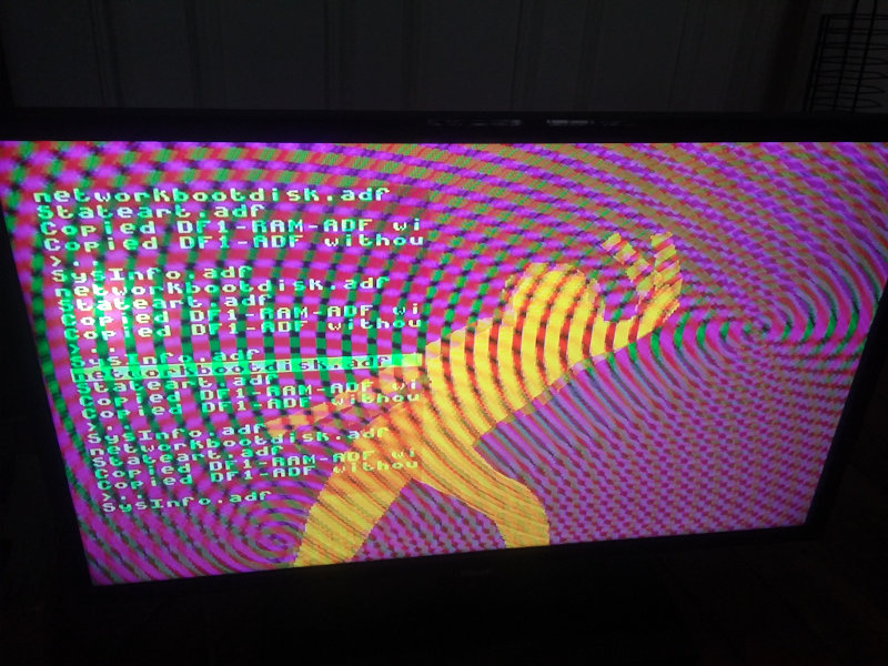

If I flash my GOTEK with “.../HXCFEUSB_Gotek_HxC_firmware/Artery_AT32_Gotek_HxC_Firmware/v5.x.x.xHxCFEUSB_V5_0_2_11a_OSD.UPD” My OLED screen does not turn on, but I also do not get anything coming up on my 1081 CRT monitor (which is connected from the RGB out to SCART on the 1081).
I also tried the “.../HXCFEUSB_Gotek_HxC_firmware/On_Screen_Display_Firmware/HxCFEUSB_V3_8_3_1a_OSD.UPD”, with the same result.
Is there something I need to press to make the display come up? Or do I need to Wire GREEN to a chip, somewhere earlier in the hardware chain, rather than on the output? The Amiga 1000 does not have the ferrite you have in the A500 picture, and I assumed that as long as I connected to Green somewhere, it would work?

OK, the answer is that unless you have an STM32 GOTEK drive, this feature has not been implemented yet. I wish the manual pages were updated as I spent an entire day performing the mod and repairing my GOTEK board due to an iron that was too hot. Could have been avoided if the pages just said - not compatible with AT4.35. Not a complaint, just a thought.

Re: Amiga 1000 OSD - no display?
I have finally added the AT32F435 OSD support :
Attached the beta firmware (for AT4.35 (AT32F435) Goteks)
Happy New Year ! :)
