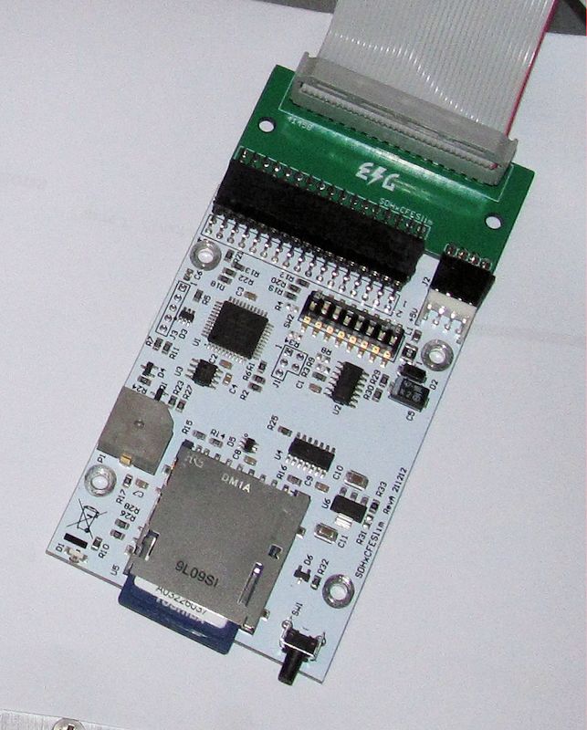

I've followed and distilled the excellent information on these forum pages and now have a slim HxC drive working with my HP 1662A Logic Analyzer. Interfacing the HP ribbon cable to the HxC was achieved pretty easily using an excellent PCB design I downloaded from one of this forum's contributors.
I modified the HxC board by adding 1k resistors to the R4, R8 & R9 pads. These appear to be 0805 pads not 0603 as discussed in various places, but the 0603s I had to-hand are fine, but fiddly for my XL hands.

The PCB design was courtesy of SKOT9000 from 2013 - developed for his HP4145B and made available in the form of Gerber files. JLC did a nice job of producing them

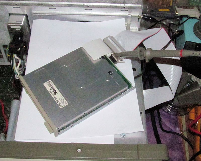

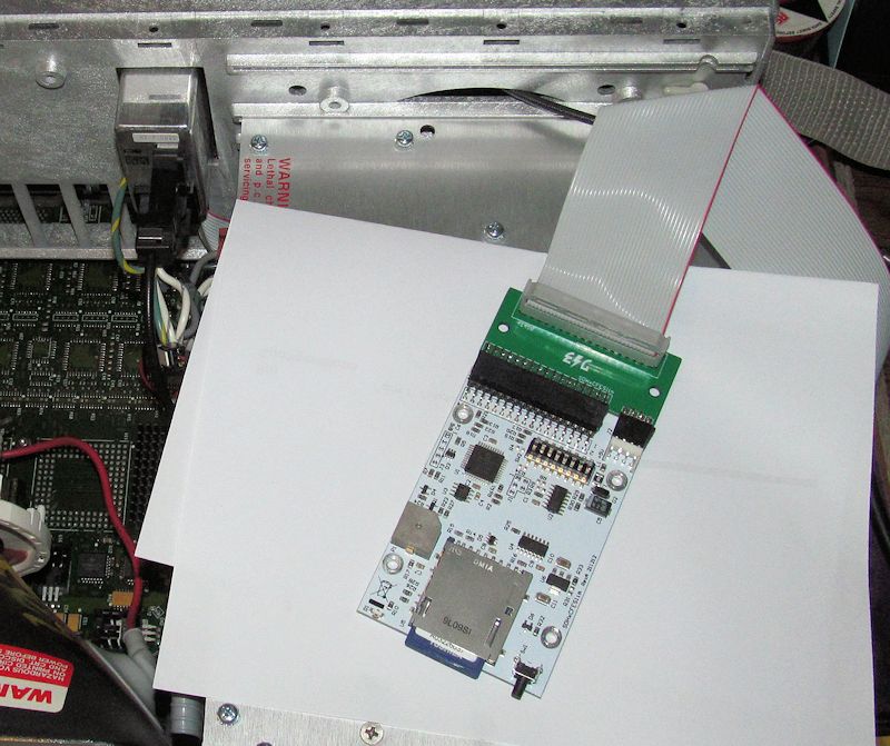

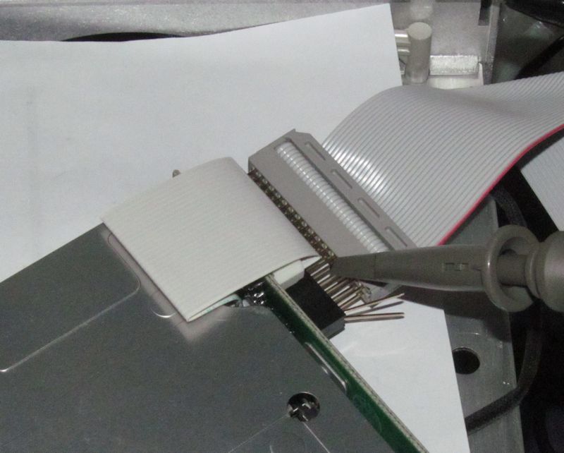

A few images of the project.
The floppy image shows my oscilloscope probe which I used to confirm that the drive spins at 300RPM not 600RPM.

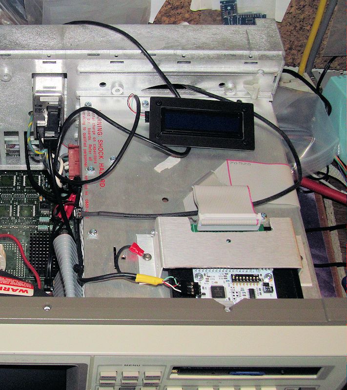

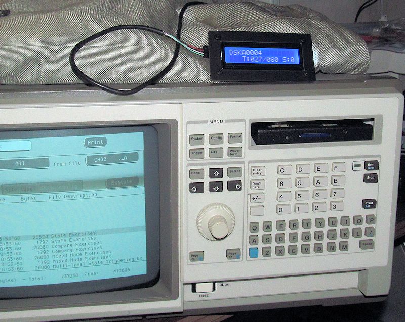

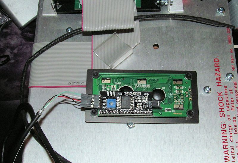

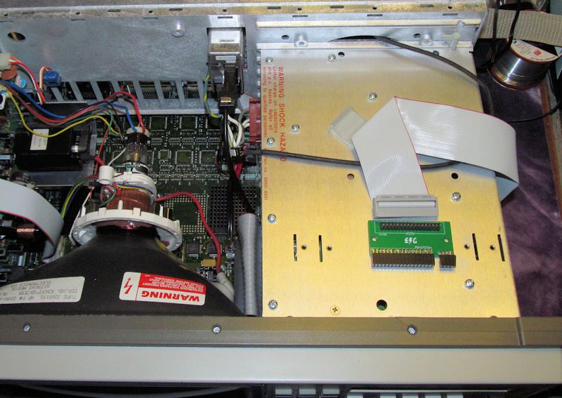

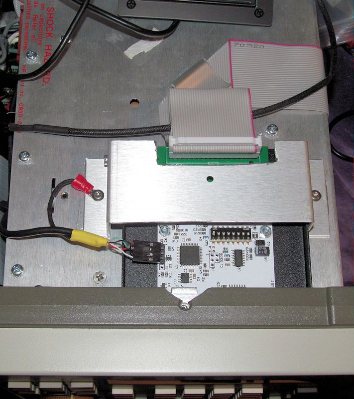

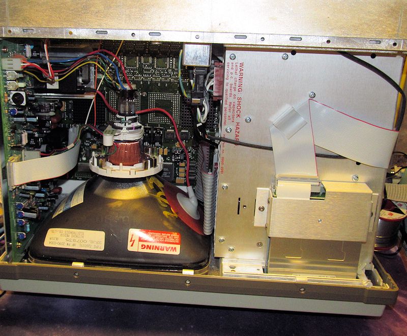

Just to finish off the hardware side of fitting an HxC Slim emulator into my HP 1662A Logic Analyzer - here are a few images of the drive fitted in the instrument. I decided to fit a 16x2 ('1602') LCD so I can keep track of which disk image I'm using. I'm going to use the 1662A to diagnose and track any problems I have with a 6502 processor circuit board that I've designed, so I will probably need to transfer listings to a PC to analyse memory and I/O read and write operations.
I needed to cut away some of the bracket that held the original floppy disk drive in place. Because the HxC slim is narrower than the original drive one of the M3 supporting screws has to be quite long with nuts to provide rigidity.
The HxC and 1662A work well together for DD (720k) images but not HD (1.44MB) size images. That's the next thing I need to look into.
