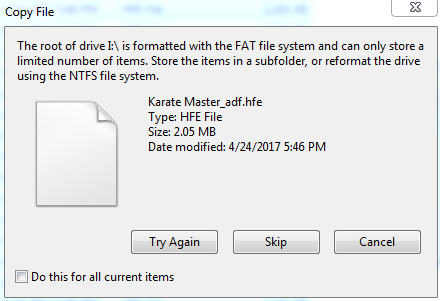

I am receiving the following error copying files to my SD card (see screenshots)> My card has enough capacity, it does copy files to it up to about 285mb. Am I missing something?

I figured out the issue, for some reason Windows 7 defaulted to format the SD card as FAT rather than FAT32. I didn't catch this apparently. I was able to transfer files to the disk without issues after this, and am able to launch them from the SD card.
