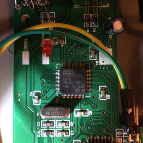

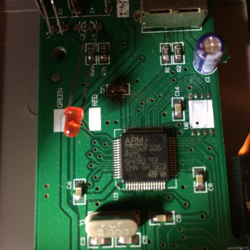

I have made some pictures of the Gotek MC.
The one working with the Cortex Firmware.
And the one working with the display and your firmware
Is this of any interest for you, maybe it is a problem with the Gotek Hardware.

It seems to be a problem with the Gotek Hardware, i have flashed an other Gotek and this one works perfect with the Amiga 500.
But its strange there's no problem on a CPC 464 with the faulty Gotek.
