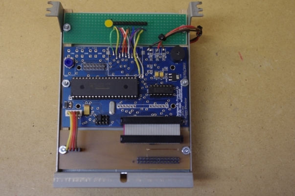

Here's a view of the HxC replacement for the SY99 floppy drive mounted in the stock bracket. The beige board at the bottom is a 26 pin to 34 pin floppy adapter (the SY uses a non-standard floppy cable). The green board at top is a breakout connector for the SD card pins - I used a SD card "breakout board" so I could mount the card to the front panel.

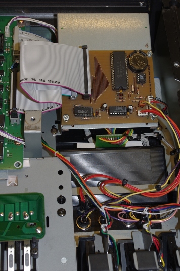

The HxC board is on the bottom of the bracket you see here. You can see the SD card breakout board in the middle of the photo. Here you also see my custom designed internal memory card - it's like having two MCD64 cards permanently installed in the SY99. Functionality is retained for inserting a card in the SY's external slot if desired. Part of the metal chassis shield was cut away to mount pushbuttons and LEDs for the HxC emulator and the MCD64 selector.

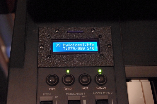

A shot of the front panel... aside from the holes needed for the selection pushbuttons and LEDs, the front panel fits neatly into the floppy disk pocket. The one LED above the select switch is a red/green bicolor LED - I added some simple logic on my memory card to combine the signals for the SD access and floppy access LEDs (green = SD access, red = floppy access). The Card A/B switch lets me switch between my two MCD64 banks.
