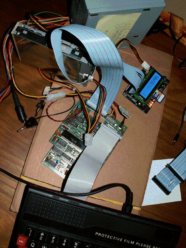

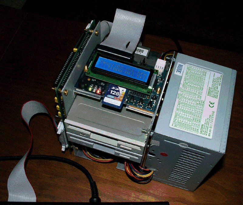

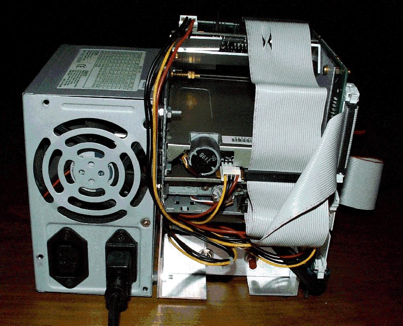

Thank you Jeff. Here is the last update, with inclinable emulator!

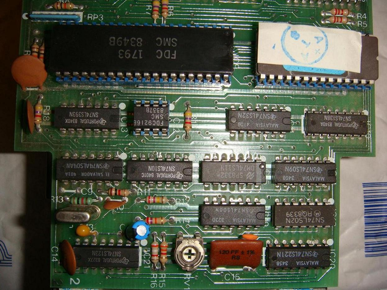

Well, I am using FDC 1793 on Cumana2 PCB.
Godzil is using also FDC 1793, but on standard Microdisc PCB.
JihemB: is your system 'Oric+Controler+drive' working fine without HxC ? If the system has some mistakes (R/W TRACK ERROR) on a real Oric, not susprising the HxC failed: I am thinking about a bad setup of the controler - MAP timing - (need scope to verify).
Could you take pictures of the Oric motherboard, and the controler (if you have the right screwdriver!). Some mods made by Oric generates mistakes.
Did you tried to use Sedoric 3.0 (I think not, reading http://www.silicium.org/forum/viewtopic ... 61&t=29481). Sedoric 3.0 is a major version and I think is the best DOS to test a system.
Best regards,
Thierry

- _PICT0049.jpg (140.99 KiB) Viewed 94209 times
- _PICT0050.jpg (143.53 KiB) Viewed 94209 times
- _PICT0046.jpg (139.42 KiB) Viewed 94209 times

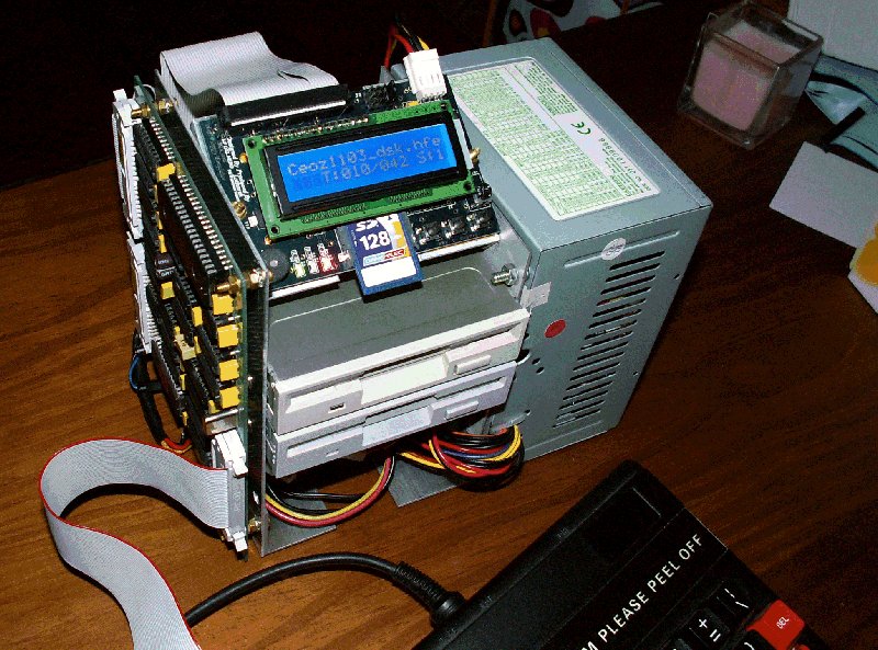

this evening I made successfull tests:
1) download ORICDOS V1.13 (http://oric.free.fr/DISKS/oricdos.zip) and convert it to HFE format.
2) boot with HxC, and backup drive 0 (HxC) to real drive (1): !FORMAT 1 then !BACKUP 0 TO 1.
3) with only real drive on ORIC, boot with the last created floppy.
- All without any errors on the 2 following controlers: Cumana2/SAB 1793 and Microdisc/FDC 1793 (please see the last setup on the photo below).
* If you have read errors with real floppy, perharps it is the floppy (altered) and/or the drive (old - perhaps need also cleaning), and/or controler tuning and/or motherboard tuning and/or PSU. Remark: 80 tracks are also not recommended on Oric for reliability.
* Oric PSU (Power Supply Unit) have poor reliability (bad voltages). In the past, I saw a such PSU burn in front of me! Today, in the Oric Community, we are using PC PSU (and 3 1/2 real floppy drives).
* So I suggest you to test a generated floppy (see http://www.silicium.org/forum/viewtopic ... 61&t=29481), and boot it with a PC PSU and 3 1/2 drive on you controler (as the picture below).
- If it is OK, you will connect your 3" drive and try to backup the system.
- If not OK, It will be necessary to tune the controler or the Motherboard (please send us pictures to analyse them), or change the 3" drive.
Best regards,
Thierry

- _PICT0053.jpg (144.07 KiB) Viewed 94204 times

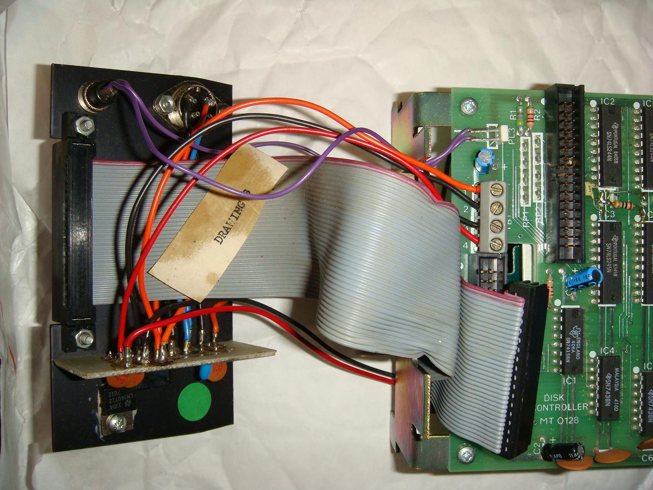

I finally found an appropriate screwdriver.
Here is how the controller looks like internally : What do you think ?
JihemB
JihemB

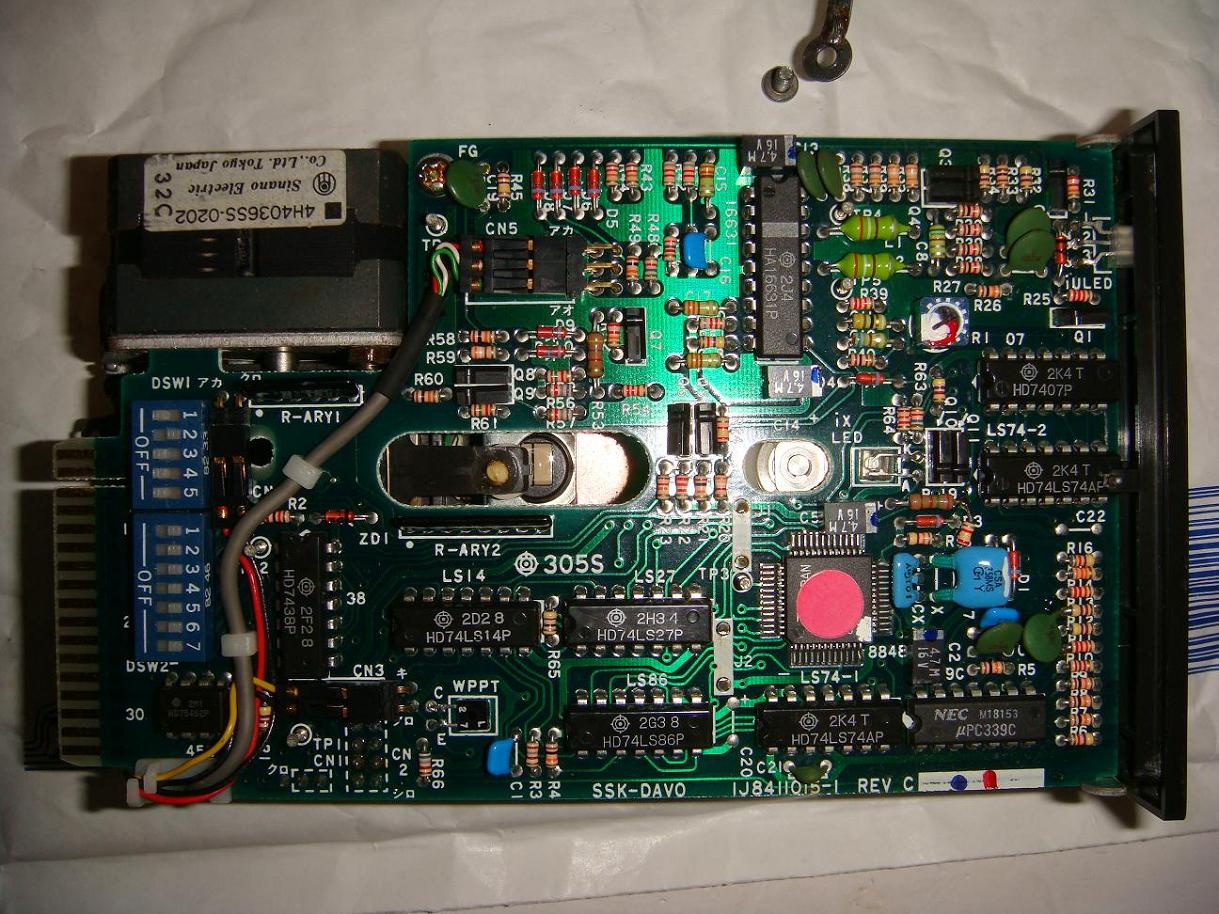

This is the 3" disc drive unit.
It is an Hitachi HFD305S model.

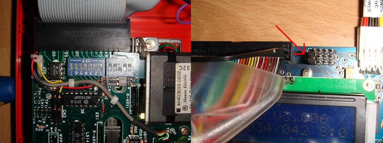

What is the switches position I should set to make this drive 1 (aka drive 'B') ?
[edit] According with "Romuald" Oric site, it seems that I have to set switch 1-ON and 2-OFF[/edit] JihemB

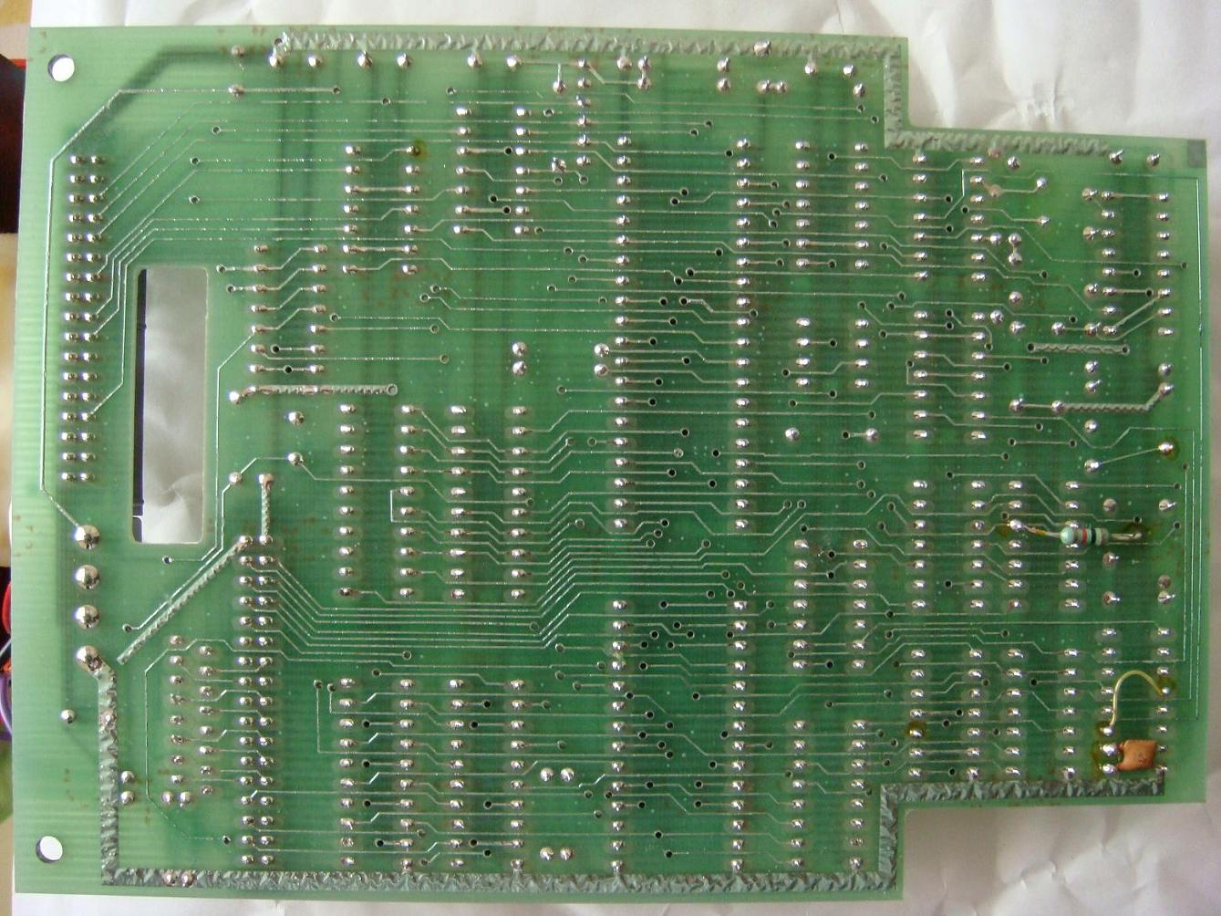

Hi,JihemB wrote:Hi guys !
JihemB
controler component side seems OK (no remark), what about the solder side (is there an additionnal transistor on it ?).
Please send us pictures of your Oric motherboard (component and solder side), to see mods (if exists).
Thierry

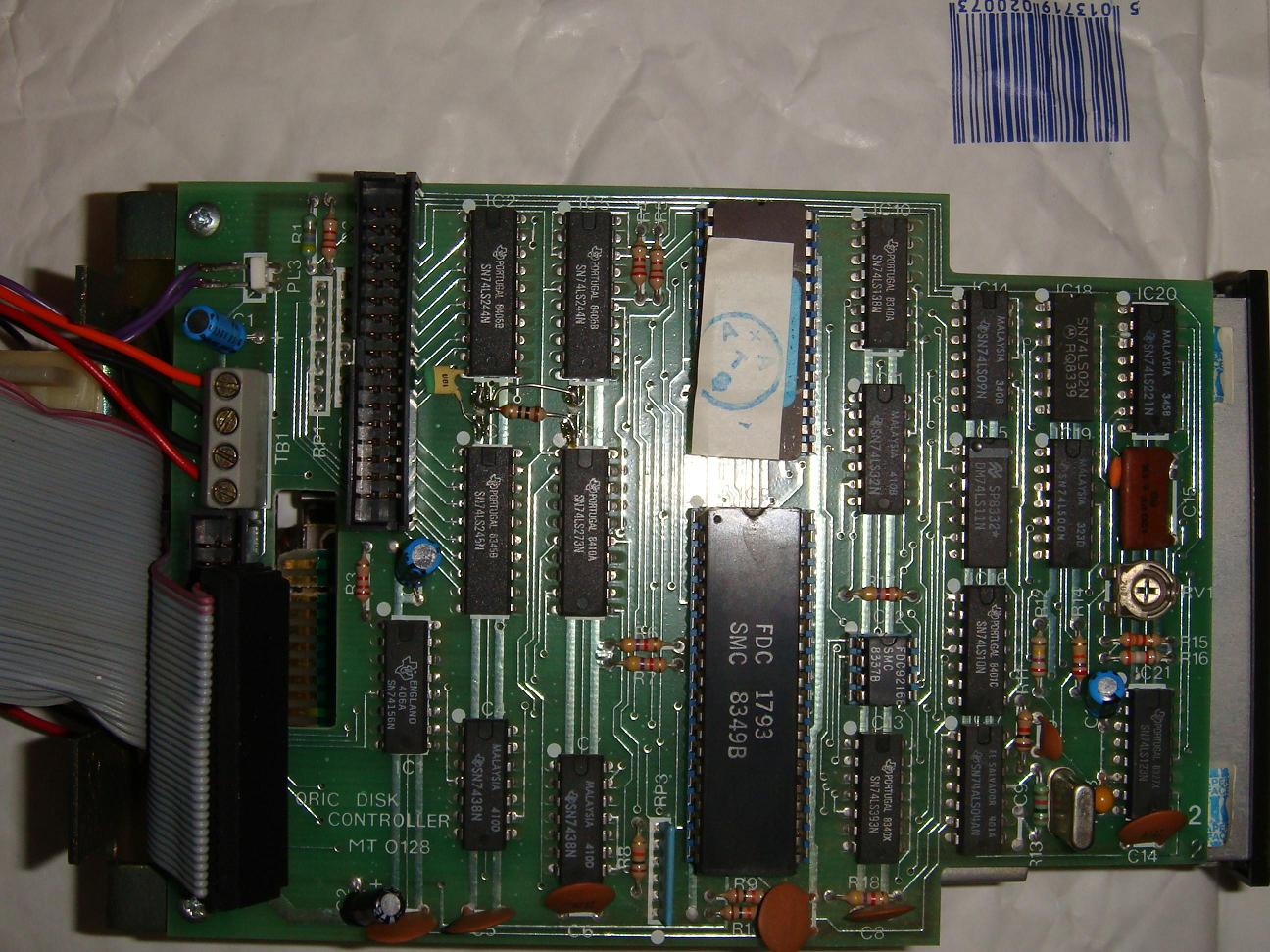

Re: Oric floppy images support
Hello, I'm back with some new results !
First of all, this is the solder side of the controller motherboard : JihemB
