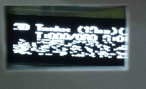

aotta
Posts: 37
Re: OLED mod
Post by aotta »
i am afraid my oled is not the right resolution... or may be i have fried it while testing the correct connection... any suggestion? :)
Kingstener
Posts: 67
Re: OLED mod
Post by Kingstener »
ooh, it looks strange... :shock:
- 0.91" OLED 128x32 with SSD1306 driver ?
- Fuses from readme?
- R/C on reset 1000nF/27K? (if it is a SPI display)
- VCC 3,3V ?
Swap of SCL / SDA brings nothing to fry :wink:
