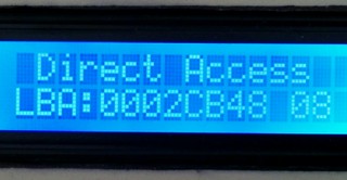

I've tested it on a A500 1mb chip/8mb fast with a CF as HDD, my floppy drive is a gotek with last hxc fw.
I succed to list the usb stick with hxcfe dir command but for the copy it fails my system is frozen some seconds after entering the command. Tested with a tiny and a 1mb lha file, both failed with same behavior.
@norb: what kind of file have you successfully copied with your gotek?

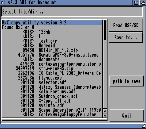

Post by norb »
GuiFE v0.4 (script Gui4CLI) for HxcFE
Requires: OS 3.0+ (Gui4CLI)
speed hxcfe. (standard a1200)
880kb to RAM: - 154sek.
880kb to HDD - 163sek.
gui0.4.zip
(1.33 KiB) Downloaded 2170 times

norb wrote:GuiFE v0.4 (script Gui4CLI) for HxcFE
Thanks! i will give a try soon and this time i will copy the files to ram, l will report the result.

For a 1Mb file it takes about 6 minutes.
FYI here is a screenshot of the display during the copy.
Thanks again to gonk23, it's a useful tool.

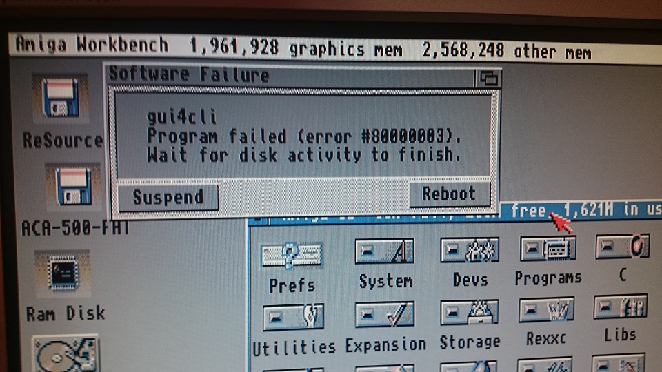

im tring to use the gui on an a500 but it faild to load with an software failure, anyone tryed it on a 500?

Post by elpiloto »
well yes, my a500 have kickstart 3.1, classic workbench 3.1 and gui4cli 3.8 was installed, downloaded from http://gui4cli.com/ami/gcmain.htm
norb
Posts: 39
Joined: Tue Oct 13, 2015 3:13 pm
Re: Hxcmount for amiga
Post by norb »
Delete all lines with word "attr" or wait for fix version
Gui4CLI dont like "attr" and mc68000
